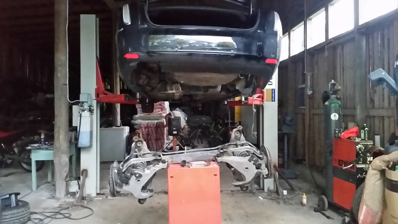

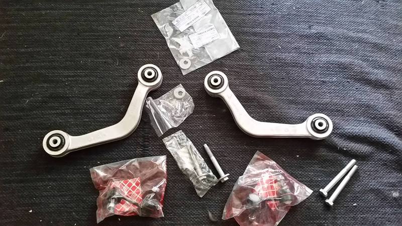

Hi,
entschuldigen Sie, mein Deutsch ist sehr schlecht, so I write this in English.
I had similar problems and I had to change upper arms, for example. The easiest way is to drop rear axle down, but it can be done within two hours (even alone) if you can use proper car lift (I used 2-pillar lift).
Rear axle is attached to body with four bolts. Additionally, you need to remove brake calibers and all electric wires.
When rear axle is down, then you need very, very good spring clamps (federspanner) like these: https://www.ebay.de/itm/Universal-Feder ... 1669170664
I used crappy ones, so I had to grind them away after spring installation.
Now the upper arms. It is a bit pain in the ass to try to adjust them when axle is back on the car, so I advise to put everything on without the springs and try to measure camber so that wheels are fully vertical (then the camber would be 0°). Then install springs and put rear axle back.
So, you don't need to remove fuel tank, but exhaust pipe tail section needs to be removed. Tail pipe takes about 5 mins to remove.
I think that 1000€ for the work would be toooooo much.
