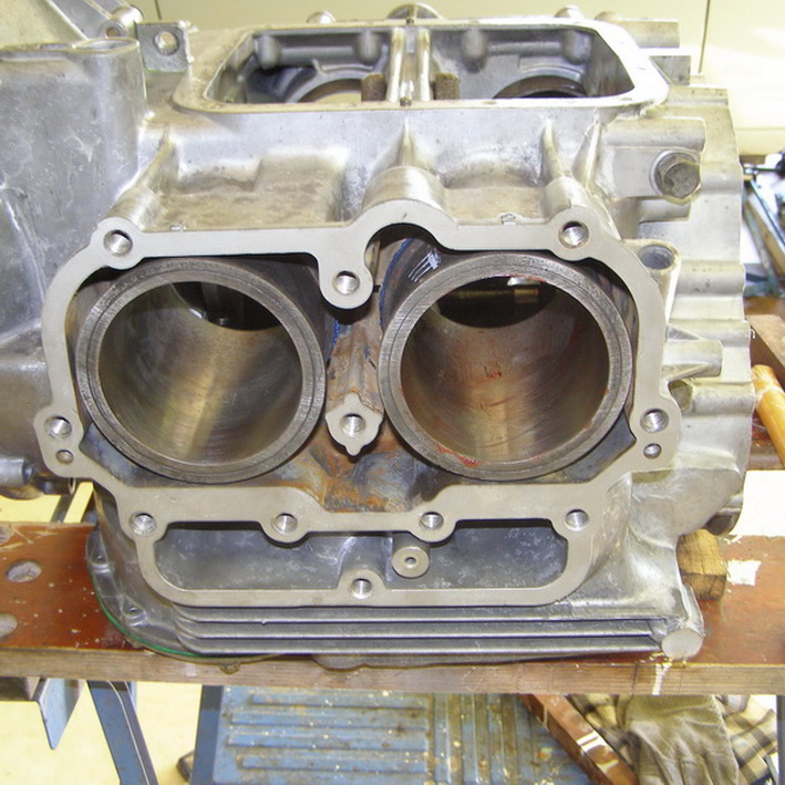

The shop that reground the liners in my Flavia engine, 815. 400 (Injection) did away with the paper gaskets.
They milled a groove in the bottom of the rim of the liner and fitted a rubber O- ring.
They also topped it of with liquid sealant, see picture.
Apparently this is the way Alfa Romeo did it in their engines.
I completely rebuilt the engine myself.
Engine has meanwhile done some 8,500 kms and up to now does not loose a drop of coolant.(knock on wood)
I can give you the name of the Dutch shop in a private message if you want.
best regards,
Bert

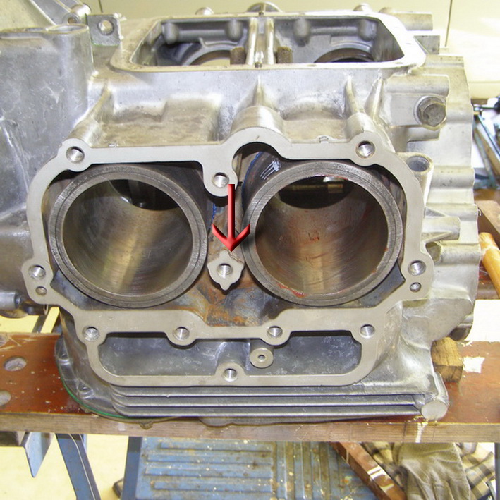

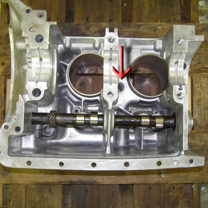

As you probably know, the tightening sequence for the cilinder head bolts in the Flavia deviate from common practice, the work from outside of the engine inward, instead of inward out.
According to the shop that reground my cilinder linings this has a reason.
The last bolt you tighten is number 11 and this sits between te cilinders see photo 1
If you look it the other side of the engine you see that the stump that holds the bolt is largely hollow, photo 2
I was warned by the shop to religiously adhere to the tightening sequence and be very careful about bolt number 11, the stump might crack on overtightening.
In the end I was so scared I only tightened it to about 80% on my own engine.
I never had to check it, so I am now on thin ice, but I think it is possible, but pleas only after you looked at the more obvious causes.

Further to my prior message.
From your post it is not completely clear whether the engine currently still leaks water, after the careful refitting of the liners and inspection of the head gaskets.
If the engine has been put together again and still leaks there is still another opportunity for leakage, unfortunetaly that would be a very nasty one.
So please don't be alarmed, I just mention the possibility.
I think it is possible to check for it, without too much effort, but only do so if other options have failed.

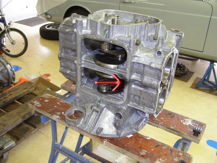

Here we go again, see photo 3 and compare to photo 2 in the previous post
As you can see the hollow stump foor headbolt 11 , sits just besides the support for the central crankshaft bearing.
So by removing the carburettors and and the top cover you should be able to see it, while you can leave both coolant and oil in the engine.
(You may want to remove the oil)
I think if you clean the area around the stump, and then pressurize the cooling system, you should be able to detect a crack there.
If it is, the cause is wrong tightening sequence or overtightening bolt nr 11.
I sincerely hope, that you won't need this information and have already solved your coolant loss problem
best regards,
Bert
best regards,
Bert
