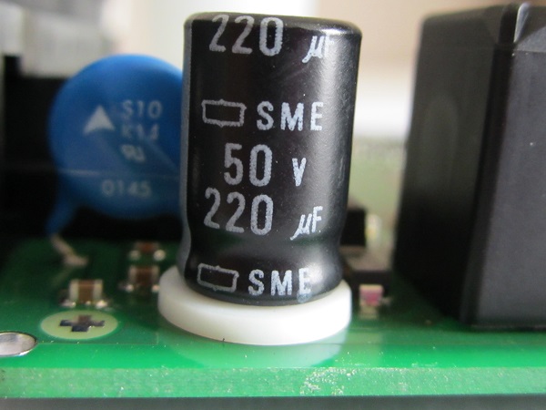

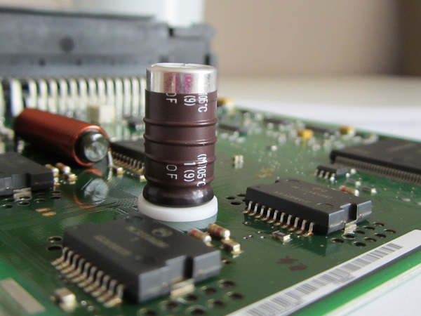

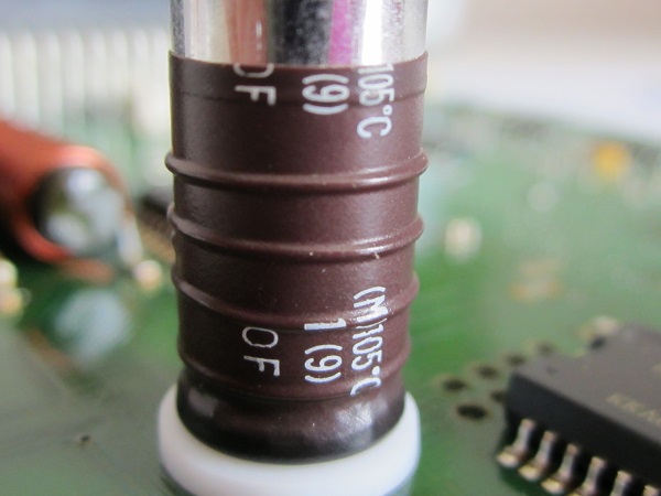

Was meint ihr,ist einer von den Elkos defekt? Ich kann nix erkennen außer bei den braunen da ist der Fuß etwas dunkler als der obere Teil vom Elko,der schwarze sieht gut aus oder meint ihr ich soll beide wechseln?

Of course you need to change them both. Their life is 2000h working time at higher temperatures, which really are higher in the ecu box because the highpower switching chips are normally quite hot. It's not the only thing that brakes down in the ecu according to time, there are even more problems and after my research it's good to get the ecu refubrished each 6 years.

Thanks for the offer Vlad, I think the 2nd electrolytic capacitors I create, only like do I recognise plus and minus on the board with the electrolytic capacitors the legs differently are long white where plus and minus is, does this know you?
Re: Skyhook
The white mark means minus
, first one goes to the connector and the second one to the chip
