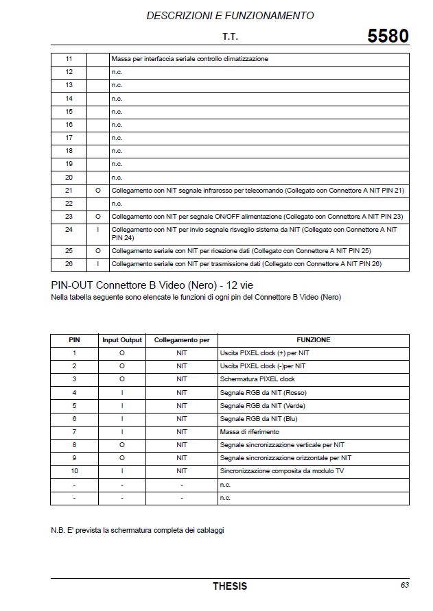

Please look at manual part 1 on page 63 in chapter 5560 STRUMENTI DI BORDO
Re: CarPC project by vlad47 step-by-step
On this page there are only some photos of the instruments lcd. Really don't see there anything usable. Look at the scheme elettrici (part 2), there's connect scheme 4091 page 287. There's a describtion of the connection, can also check it as the connector M120A at the bottom of the document.

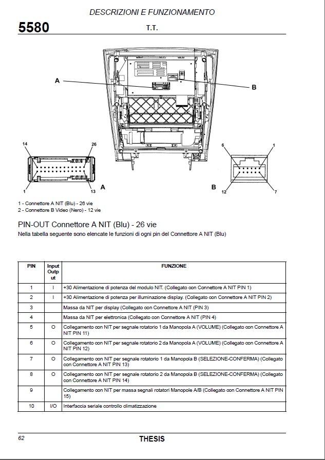

We have a different manual then. Mine is in Italian though! I show you my two pages in which the rear connections of the connect are explained. Please take a look atthe numbers and functions of plug B.
- thesis manual 2.jpg (152.87 KiB) Viewed 653 times
- thesis manual 1.jpg (154.04 KiB) Viewed 652 times
You've written 5560 and it's 5580 that's why I haven't found it
I've used the more detailed scheme in part 2, but it doesn't matter because the pinout info is the same and I really don't know why you say it's different. I can see it's all correct and corresponds also with the manual. Please have a look again to my excel file to the first table connect side and you see it's exactly the same pinout as in manual.
