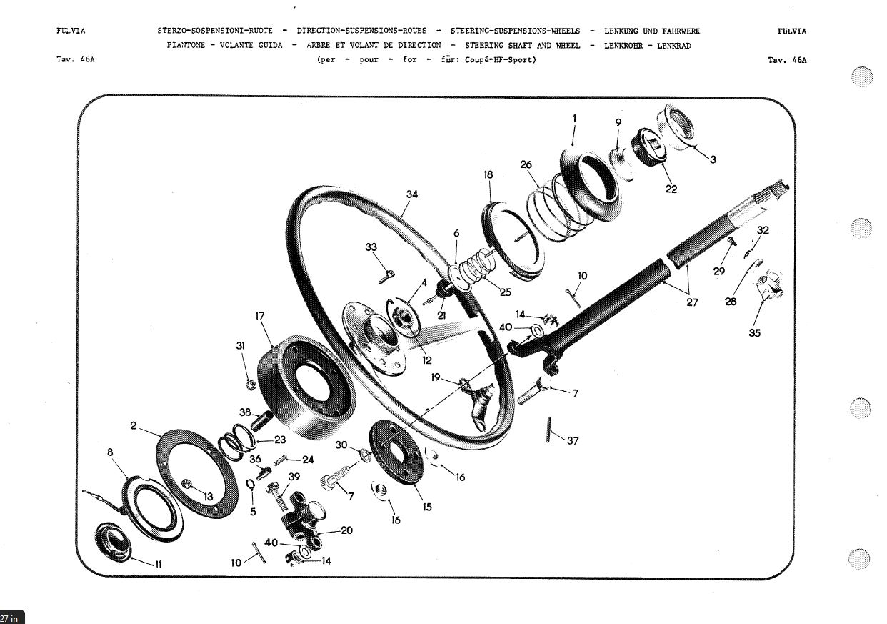

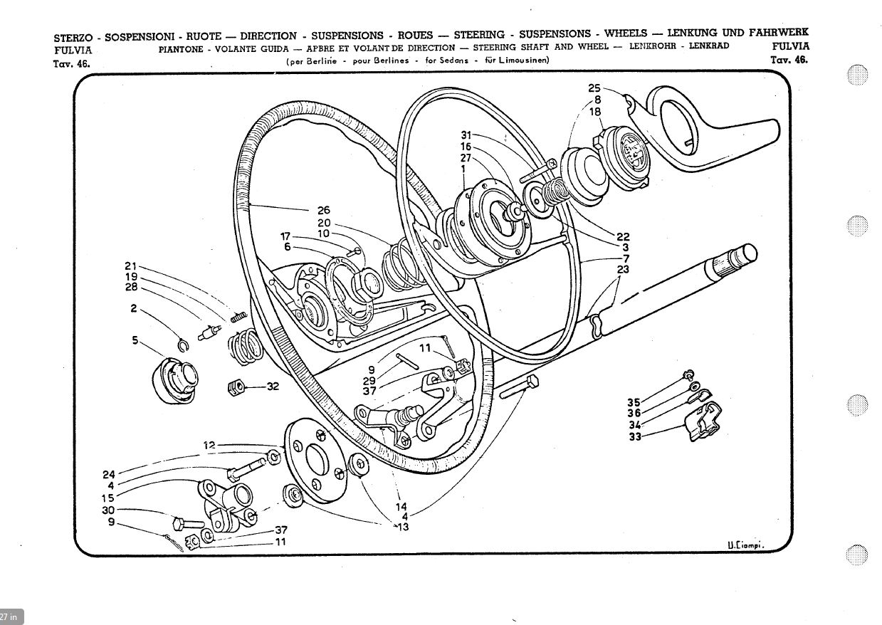

First attachment is Fulvia Coupe S1, second is Berlina S1
Pictures from the partsbook on S1 CD1 you can buy at the Viva-Lancia main page.

Re: steering wheel / horn push
thanks for the diagrams...but....does the horn push button just clip off...as you can guess I seem a bit slow to work it out
turn the chrome ring(number three) left to unscrew .
Thanks for the help it makes sense now
