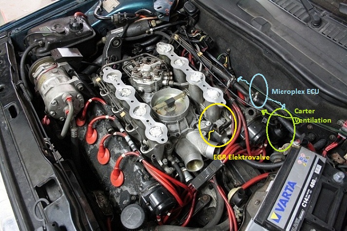

If my memory serves me well, there are 3 small diameter hoses attached to the intake manifold. One sits on top of the black round steel box for the crankcase ventilation, just behind the distributer cap.
There is another one (originally green hose) that is attached to the Microplex ignition ECU (in the engine compartment behind the fire wall) to measure the vaccuum in the intake manifold to advance ignition timing.
There is a third one connected to the EGR (exhaust gas recirculation) elektrovalve. This elektrovalve regulates that at a certain temperature and rpm the exhaust gasses are being directed back into the intake to minimize toxic exhaust gasses. It happens quite often that people disconnect the EGR system. Doing this by just disconnecting this hose will, in contrast to what a lot of people think, not cut exhaust gasses from recirculating but force them to circulate all the time.
Attached a picture from the components or the hose leading towards the components.
