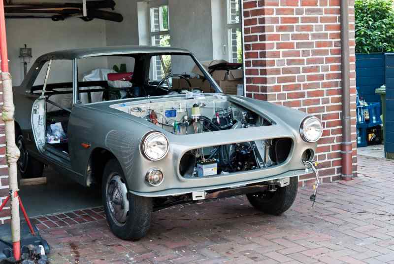

Please look at:
http://www.classiccarcolors.com/germany ... ton_finden
You will find the correct paint on this site and you can buy it. Ist from Glasurit! Look at my Flaminia, thats grigio albany.
Best regards
Klaus
