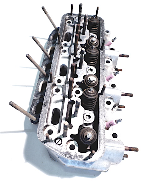

Hi Hubert
Many thanks for your reply. There seems to be 8 long studs, 4 per head, see attached photo. The 2 centre ones are indeed under the carbs and the nuts are released so my guess is mine may have rusted a little and are causing the inlet manifold to stick a bit.The 2 outer studs have been removed. I'll have to keep trying with the penetrating fluid in the hope that the manifold will release.
Regards
Jensen
Regards
Jensen

Re: 3c Inlet manifold removal
Hi all once again,
I still have my Flaminia and although I've been working on other cars I am still collecting spares and tinkering when I can. I still have had no luck removing the inlet manifold. The 4 central studs appear to have had a chemical reaction with the aluminium and a stuck very fast. I've tried penetrating oils, coca cola, mild acid, heat but not much as I'm worried about melting the manifold and lots persuasion with various levers. Don't think there is room to get a stud extractor into the countersunk hole. Anybody else had similar problems?
Jensen
Jensen
