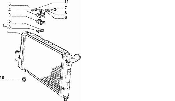

could anyone please help me fit a radiator in my LS Turbo?
i saw a series 2 workshop manual but it is not the same.
any diagrams or pictures would be very helpful, as would scans from a workshop manual.
also, the lens has dropped off one of the front fog lights - any idea how to refit this?
many thanks

According to eper it is only shared with the Croma Turbo from 1990-96. The drawing looks like the attached picture, however that might not be correct. I would try and search ebay or find out if Nissens (or another manufactureres of radiators) has it in their product list.

- thematurbo-radiator.jpg (31.3 KiB) Viewed 10232 times
