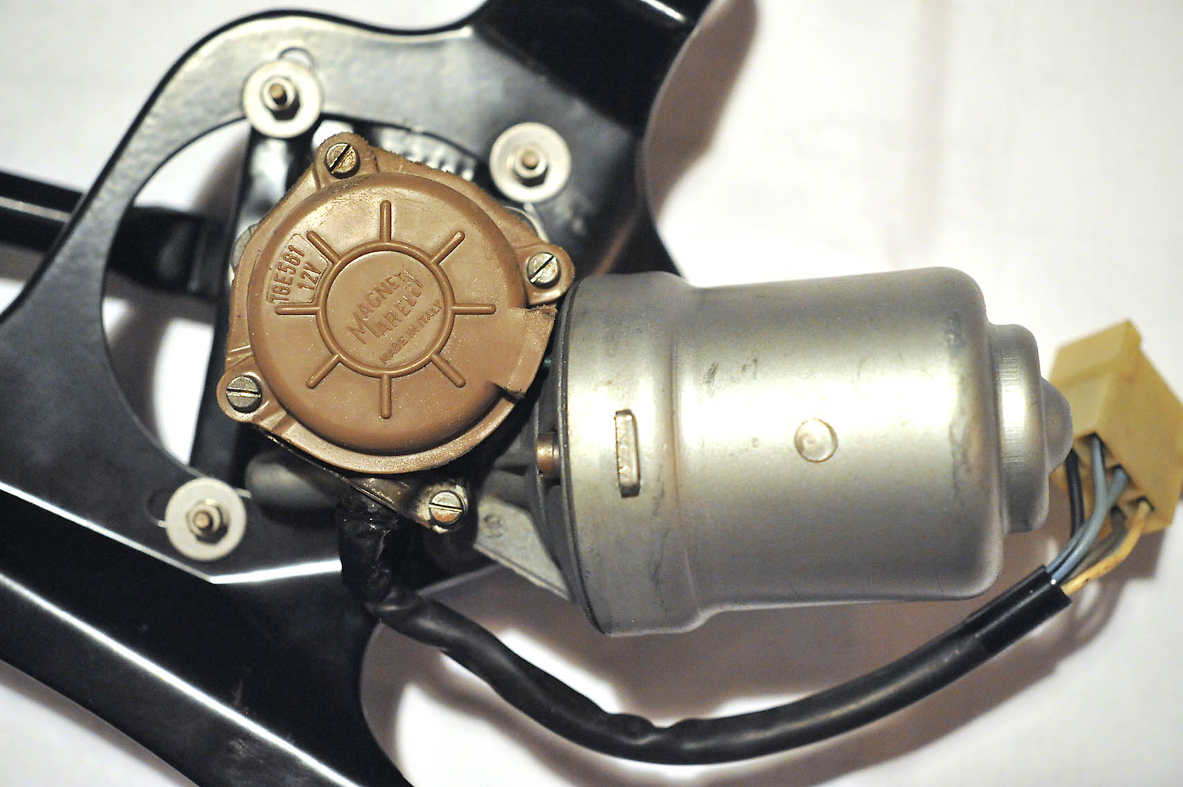

I can do better than suggest an alternate motor; I've got a perfect, rebuilt berlina wiper motor and armature assembly that I'd be happy to sell.
Long before I got my HF, someone for some reason replaced the original Bosch wiper motor and arms with a Marelli berlina unit. The wipers never worked very well, but it doesn't rain much here, so sorting it was always a low priority. And of course it never occurred to me to check to see if it was completely wrong; I just assumed that it needed a cleaning at some point.
I recently had all of the electrics gone over, to fix all the bodges from pervious owners. The guys who did the work are incredibly detail oriented but they aren't Fulvia experts and, not recognizing that it was the wrong unit, they cleaned and completely rebuilt the motor, cleaned all the contacts and connectors, and powder coated the arms. It wasn't until it came back from the powder coater that I looked at it and realized it wasn't a Coupè unit at all. So I located a correct Coupè assembly and we repeated the entire exercise.
Meanwhile, I've got the berlina assembly--probably better than when it left the factory--sitting on a shelf, waiting for a berlina that needs a ridiculously good wiper motor. So it won't be dirt cheap, but I'll make a decent deal for it to go to a good home. Photos attached.

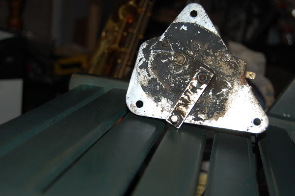

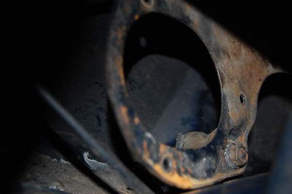

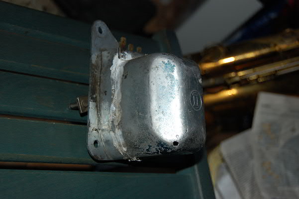

Thanks for your suggestions...The Motor is BOSCH part no 0 390 116 908. I'm not sure I can see how I can substitute Eds motor and mounts for mine...but I enclose pictures of mine and the mount. As I say, mine spins freely and apparently happily when not under load but as soon as I connect it up to the mechanism it fails to drag the wipers across the screen. When I originally opened it up the armature assy was rusted on to the magnet and steel side pieces. It required careful surgery to pull apart and rebuild but the only thing that is not original is the spring holding the brushes on to the commutator. This was salvaged from a faulty cassette recorder and carefully redesigned to replicate the exact tension of the original (just kidding). Is it possible that under load the brushes are being forced away from the commutator thingy.(that is the right word isn't it?).

Re: wiper motor Bosch part no and photos!!
The motor on your pics is the one I know from the S1 Fulvia's.
Did you measure the voltage at the terminals when it is wiping?
Any load increases the current it draws. If connections have become bad the voltage loss may be high.
The dashboard switch is often a source of voltage loss. The contacts are riveted together. Over time the resistance becomes very high. I always put some solder on it. Same goes for the contacts on the fuse box. The current also goes through the contact switch.
Is the ground connection ok? It should be connected to the M6 bolt at the bottom of the bracket under the bonnet hinge.
Also it is almost always necessary to clean and apply new grease to the spindles of the wipers and the bushes the spindles turn in.

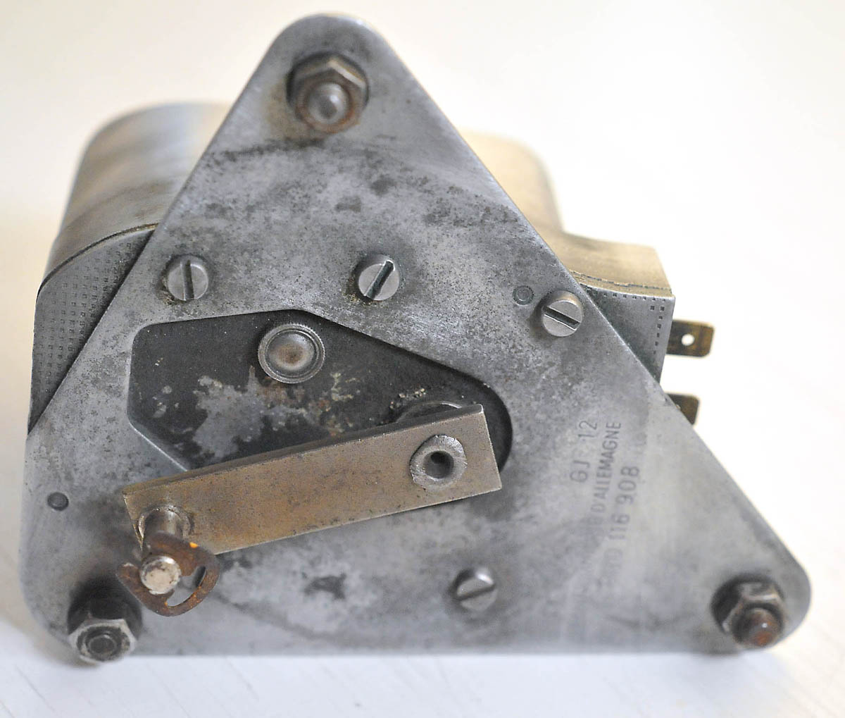

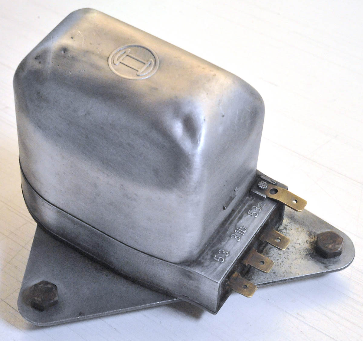

Ah, well, I've got a spare Bosch 0 390 116 908, too. (pics attached) Not rebuilt, but good used condition. If Huib's suggestions cure the problem, let me know.
