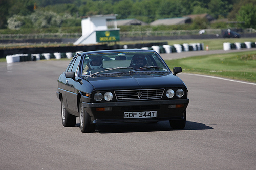

Greetings,
Modifications range Nearly finished. So far:
straight front to rear exhaust (105 dB at 4500 rev.)
WRX STI suspension made to fit.
Carrera seats in leather and Suede
picture from Lancia Goodwood Race Day
soon twin Weber IDF carburettors.
- goodwoodfrt.jpg (92.77 KiB) Visto 848 volte

A Racing Gamma is always amazing.
Which BPH do you think to rach with the double weber carbs ?
Are you going to use Alfa 33 carbs ?
Congratulations !
Congratulations !

One item not mentioned
front spoiler/splitter - previously Dedra rear bumper
