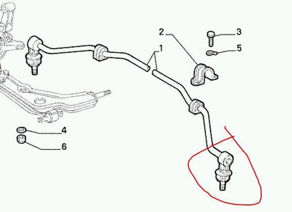

Hi
I need the little bar with ball link attached to the torsion bar (please see attached drawing) on my 1996 Kappa 2,0.
But in Denmark I can only get it complete with the torsion bar, a 350 EUR assembly.
Any advice?
Ole W.

Re: Kappa torsion bar
There is no such separate detail according to eper.
What do mechanics do In Belarus - they modify this bar by cutting the old tips from stabilizer and replacing them with new onces from fiat DUCATO.
I've got such one on my coupe
