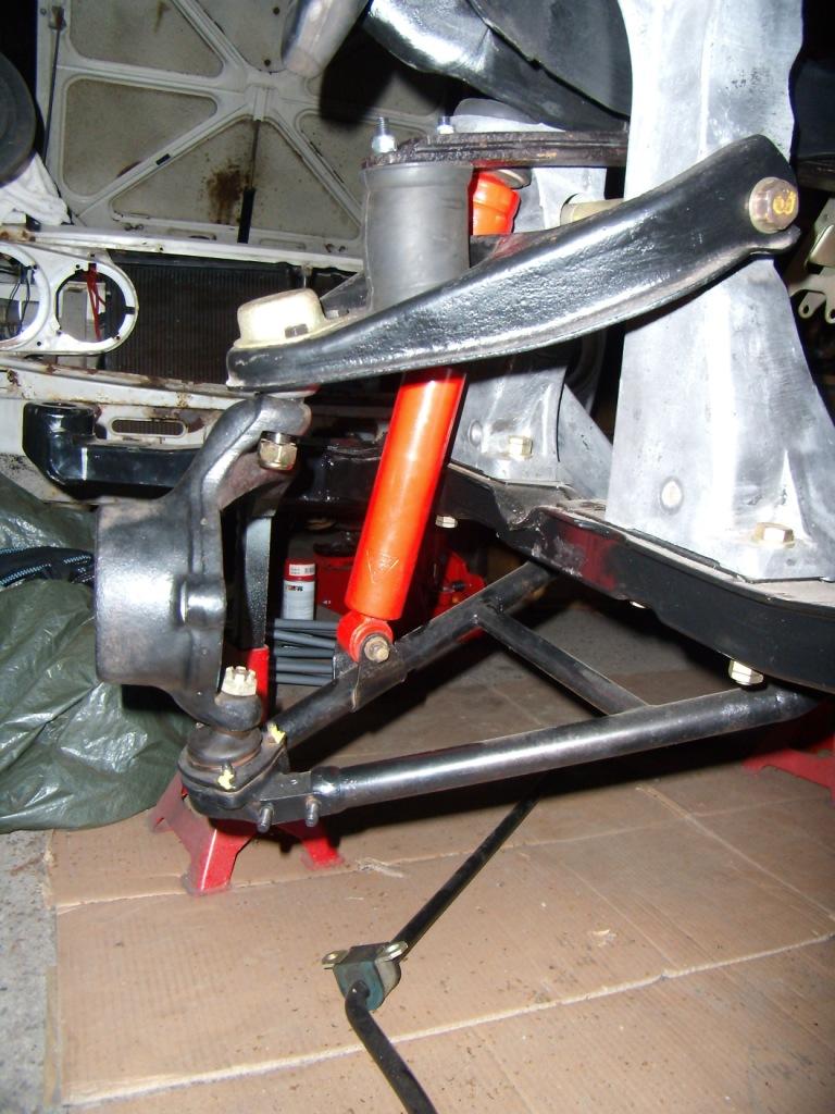

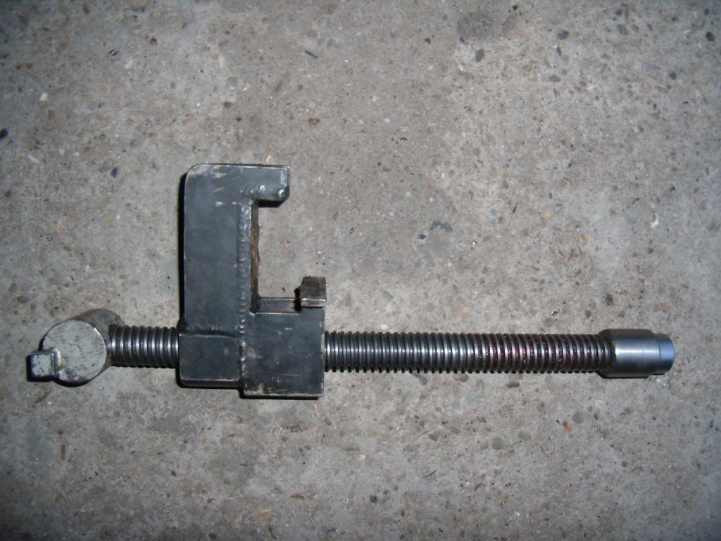

Re: reinstall transverse leaf spring
I put the leaf spring back on the subframe of my Zagato last week.
Fresh in my mind I can tell:
without any good tooling: get some help! It's better to do this with 2!
You can lose some bodyparts if the jack jumps away....
so be very carefull, girls only like little scars!
Before you can fix the spring, unbolt the upper suspension triangles.
Put the leafspring in place and bolt on the bracket (parts no: 1603727 or 1603726) (do not tighten the bolts yet)
bring the leaf spring to a horizontal position (by using jacks or much easier the correct tools: see picture)
tighten the bolt of the bracket
bolt on the upper arms (but nut tighten the bolts yet)
put the buffer ends (parts no: 1603055) in place
bring the upper arms in place according to the manual: 6-7 cms from the seat of the upper arm ball joint to the rubber stop (be sure: check manual!!!)
tighten the upper arms
bring back the swivel in place
release the tension on the leaf spring
mission accomplished!
check fingers ... no one is missing:
time for a beer!
-D
Bart
Bart, that's perfect, thanks. And I won't be doing this by myself, but I appreciate the warnings--fingers are very useful.,
We're going to fabricate a copy of the factory compressor tool that spans the subframe towers.
Johnny,
The tool is shown in the factory manual (as always, RTFM). It's essentially a channel (we'll a 2" or 3" standard steel channel) that sits on it's 'back', bolts to the top subrfame mounts (obviously with the subframe out) to keep it in place, and extends about 4" - 6" beyond the subframe at both ends. At each extension is a threaded rod that extends down at an angle (tapering in) to grab the ends of the leaf spring. By tightening nuts on the threaded rods where they pass through the channel (tightening both ends equally), the spring ends are pulled up and held in tension. My manual is at the shop, or I'd scan and post the photograph from the manual that shows the tool in use.
