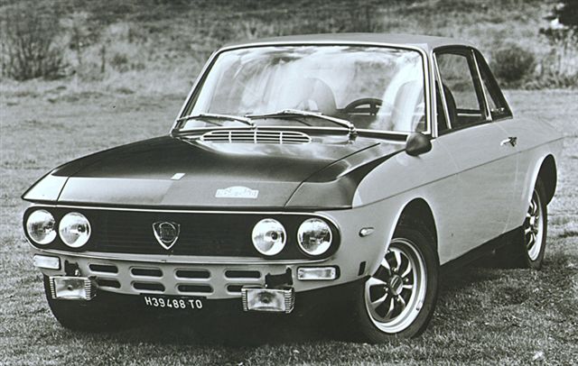

Re: Fulvia 3 / Monte Carlo ?
This is what you have to look for.
regards Andreas
regards Andreas
- lha078_fulviacoupe1_3smontecarlo1970_1974_800.jpg (70.44 KiB) Viewed 910 times
