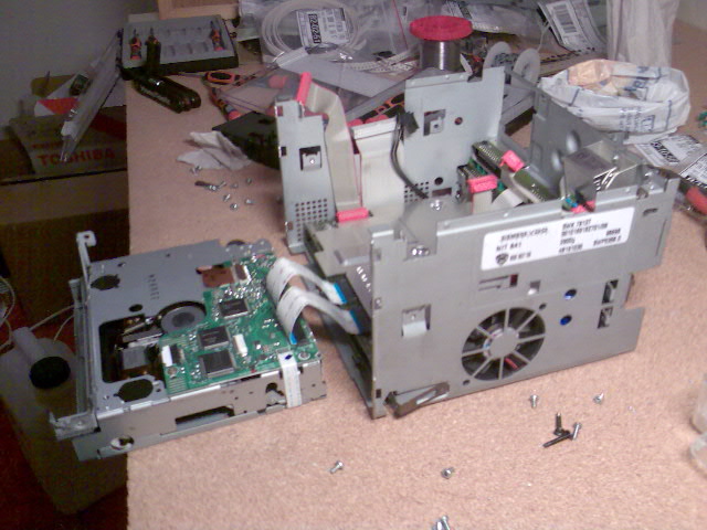

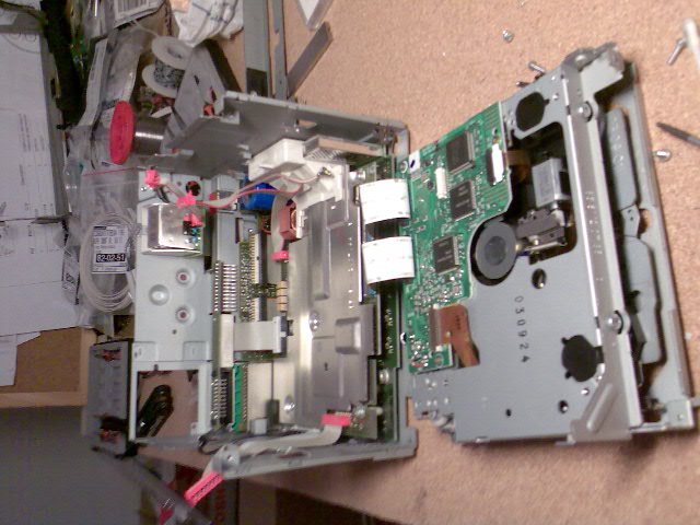

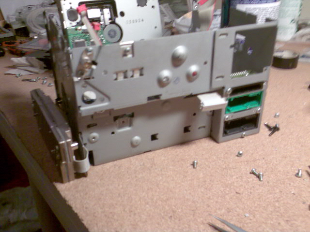

Mein (Original-) CD-Magazin wird nicht ausgeworfen, hat jemand Tips?
Re: CD-Wechsler
You have to disassemble, and clean the lens.
My CD changer and internal CD reader wasn't good also. (Cannot read magazin error message)
After clean works perfectly!
Some pics from Internal CD drive:
(sorry, i cannot find my pics about CD Changer lens cleaning... simplier, there is a hole on the CD changer mechanic, where you can reach lens.)
- kép006_lens.jpg (31.24 KiB) Viewed 523 times
- kép003.jpg (78.63 KiB) Viewed 523 times
- kép002.jpg (83.37 KiB) Viewed 523 times
- kép000.jpg (64.7 KiB) Viewed 523 times

Re: CD-Wechsler
No... the universal cleaning disks not works... (I tried two type...but nothing...)
Cd Changer disassembly is simplier than the Nav Cd.
You have to remove the case, and You can see a hole, where the lens can be visible.
(Maybe you can move the CD changer head manually this location)
For cleaning don't use alcohol! Only a dry and soft paper or textil!!
