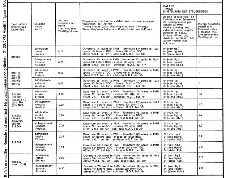

Re: Cam timing
Andrea is of course correct. For the 302 engine it's 1 mm, not 2.2 mm. See attachment.
Peter

Whether you use the 1mm of 2.2mm for setting the timing depends on the camshaft. The 302 engine does have an 818.100 camshaft which needs 1mm. The 303 engine has a 818.342 camshaft which needs 2.2mm. On the vernier camshafts the number is often engraved on the camshaft.
