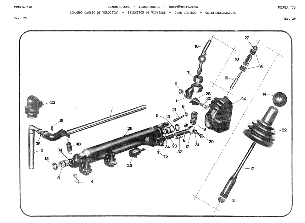

Does anyone know if it is possible (i.e. not theoretical!) to change the two bushes on the 5 speed remote gear change linkage?
If so what is the procedure assuming the car is on a ramp.

Remove the whole extention from the car by removing the 4 nuts from the gearbox and replace the bushes on a bench. No weekend job as the bushings probably have to be made.

can this be done with the gearbox in situ ie still attached to engine in car?
I have two new bushes bought on ebay and a new rubber dust guard for the front link. The bushes surprised me as they look like ceramic material.
Any further info would be great.

Hi Tim,
Impossible.
Removing from and reassembling on the car is given at 110 minutes in the Fulvia time schedule book. Revision itself is 70 minutes given.
There is a possibility, nbr 7 on the drawing, is also bad. So you should have that also, or have it made when all is disassembled.

Hi T, is this something you have to do or something you just want to do ? J

Bit of both!
Yes they are 200k miles old and give a sloppy change, but if not too drunk you can still make sweet shifts.
I am dealing with the rear suspension so with the car immobile I thought it might be a neat idea but then again a bottle of snaps is also neat..... did I say that???
