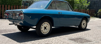

with regards to the rear springs I'm sure something isn't quite right, it is nose down, noticeable higher in the back and unlike any other I have seen, hopefully just a setup issue, if it requires new leafs then it will have to be done, will also take a look at the de carbon shcoks, thanks

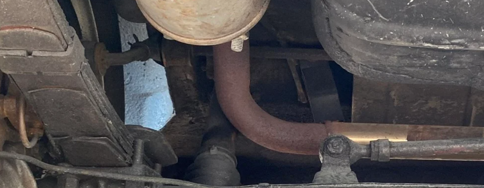

The high tail is usually wrong mounting of the rear anti roll bar. It has 90 degree bends on both sides. The ends should be horizontal and point to the rear. It is however also possible to mount them pointing down. This causes the way too high tail.

well the ARB certainly isn't sitting horizontal

There is something wrong. I can't really orient myself on your pic.
The front is too low.
Re: new owner - fulvia s1
definitely something making it sit wrong isn't there!
