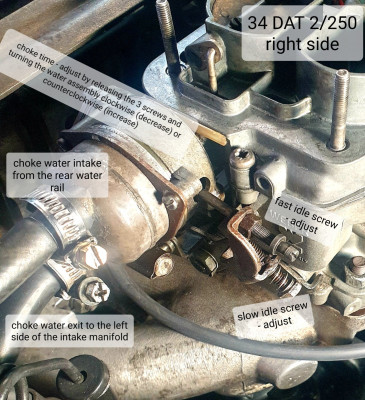

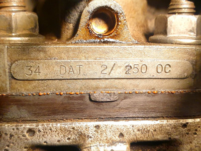

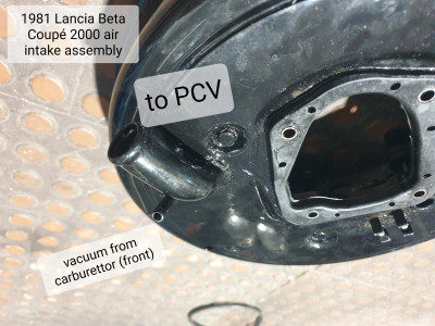

I have a 1981 Lancia Beta Coupé 2000, originally from Belgium, that comes with a Weber 34 DAT 2/250 carburator. I did a major overall to the carburator and everything seems to be working fine. Nevertheless I found out so little information about this model and i had so much trouble finding out what goes where that, to eventually facilitate others, I decided to provide the main aspects of this specific model in a few pictures. Sampaio

Thanks for the very clear pictures. I must start adjusting my Beta Weber and it will be a great help.
