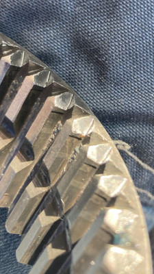

We did the gearbox because the second gear was not working properly and had oil leakage problems. We opened the gearbox and changed the first gear pinion for a new one, a third gear pinion for another one in better condition and two synchronizers.
The problem is that now the third gear goes out on its own in neutral when braking or slowing down. I have been told that it could be a spring that goes inside the selector fork, but it didn't do it before. Now I can't open the box again either
