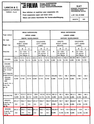

Shims are usually pieces of steel with very exact sizes in particular thickness. In this case they are rings much like washers. In our shop we call them shim rings rather than washers to express the importance of exact dimensions. The shim rings have a thickness of 2.00 mm. The M14 washers are 2.5 mm with some tolerance.
Best buy a digital calliper or rather two. One with a range of 15 cm and one with a range of 30 cm.
I am now giving some dimensions from the top of my head. Let me know if you measure differently
Distance between the mounting surfaces on the alu tower: 240mm
Distance between inside of ears of the wishbone: 269 mm (see page DT Fulvia 07-0030)
Here you see that if the silent blocs protrude 12.5 mm on each side, the distance between mounting flanges of the silent blocs is 240 + 12.5 + 12.5 = 265 mm. This is 4 mm less than the space of 269 mm between ears of the wishbone. This play of 4.00 mm is solved by inserting a 2.00 mm shim ring on each of the two sides.
The 269 mm of the wish bone should also equal the sum of:
2x shim of 2mm = 4mm
2x silent bloc of 49 mm = 98 mm
3x spacer bush: oops I forgot but should be (269 – 4 – 98)/3 = 55,67 each

I have shims and washers in the correct sizes. Upon checking the inside ears of the wishbones, the left side wishbone measures 269mm but the right side measures 274mm. Not sure what happened to cause this. The one ear is bent out and not straight down when compared to the left wishbone ears.
Please see the link for more detail -https://drive.google.com/drive/folders/ ... sp=sharing
Thanks again for your assistance.

269 mm is the correct width of second series as Huib wrote.

Check the Flavia 820 book. That one is wider at the top.

It is important to have the dimensions A, B and C equal.left and righ and correct.
If the bad one you have corresponds with Flavia 820 I would assume someone put in.a Flavia one. It does happen that we get a car with different wishbones left and right.
If you don't have the measuring tool option nr 1 would be look for a guanteed to be good one.
