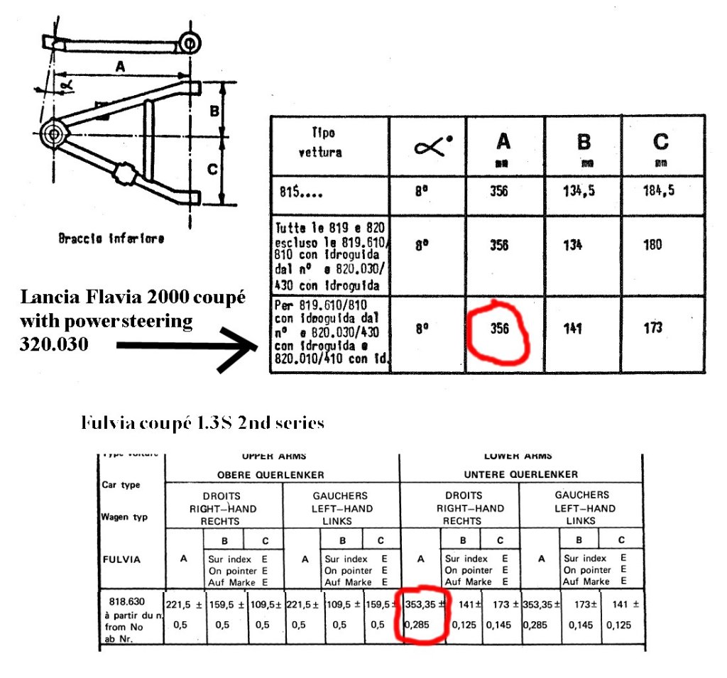

We are restoring a Flavia 2000 coupé. When measuring the lower suspension arms we measured 353 mm for dimension A. This is the length of the arm of the 2nd series Fulvia coupé. For the Flavia 2000 coupé this dimension should be 356 mm.
Does anybody have arms which are guaranteed to be from a Flavia 2000 coupé with power steering which we can buy or borrow to check the dimension and convert a Fulvia arm. Or if you have the tool to measure the arms can you confirm the Flavia arm is different from the Fulvia arm?
