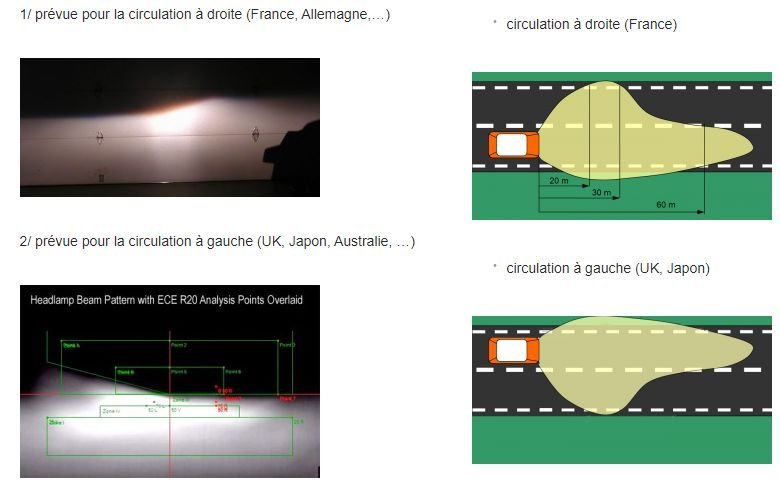

On the drawing attached, the top images for driving on the rigth side of the road, on the bottom images for driving on the left side.
So, depending of the country, the outer headligth units are not the same . No problem for the inner headlights (high beam)
