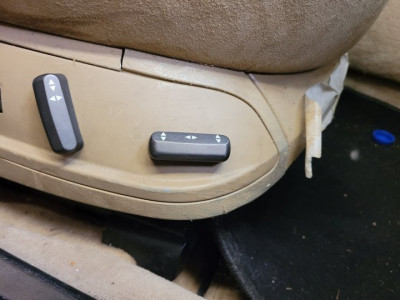

Here is the bottom of the seat. Same color and same problem as with the handles above the doors. The handle above the driver door has been cleaned and is now dark (dark brown or black).
Do you think the cause is bad quality paint? Or does the stick stuff come from the plastic under the paint. In which case the procedure should be something like:
properly clean.
Dasty seems to work Good. I just bought a pallet of Dasty including the Dasty Professional. Logical would be to take off the parts. Put in the ultrasonic bath with Dasty. Spray with a neutralizing primer. Spray with color.
Would this be long lasting?
