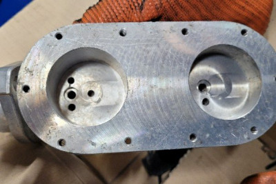

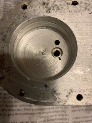

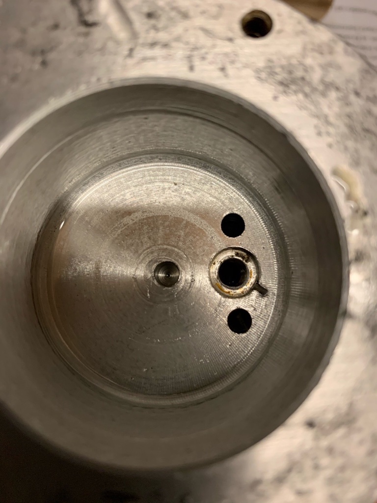

Hain, I agree that a cut through drawing down the center axis of the BMC will not show all and looking at the drawing you are right it wouldn’t work. I have attached 2 pictures of the front and rear chamber where the real fluid ports are shown.
I still can’t figure out what the very small hole in the recessed hole in the rear chamber is used for.
Having said all that everything looks fine but I still can’t understand why the rear outlet port isn’t flowing. [attachment=0]278133E9-9509-4742-9A27-B4588B30437A.jpeg[/attachment][attachment=1]2D72C29B-FDFA-4995-908A-73C44C5A9A2E.jpeg[/attachment]

Your problem is most likely with that hole. The plunger must go back completely.
If it does not there may be one cause or a sum of causes.
The copper part not polished polished polished enough.
The O ring inside the housing bad or wrong material. It must be EPDM.
The springs inside the MBC are swapped.
The spring on the pedal is gone or too weak.
The spindle of the brake pedal is partly seized. With nothing attached to the pedal it must swing SMOOTHLY.
The pin on the booster is too long.
No free play on the pedal. You need a bit of free play there.
The nut locking the rod from the servo on the pedal may be too tight. Or too loose.

Yes that is the one I am afraid of maybe has corroded a bit so that the fluid cannot pass freely. I have measured the seals and they are same width as the old ones.
I might drill it up to 1mm. I don’t see it should do any damage to functionality.
The rest of the BMC is working as supposed to now that I know where to place the springs👍
I will polish the brass plunger some and finally ask Historic Racing about what material they use in the repair kits
