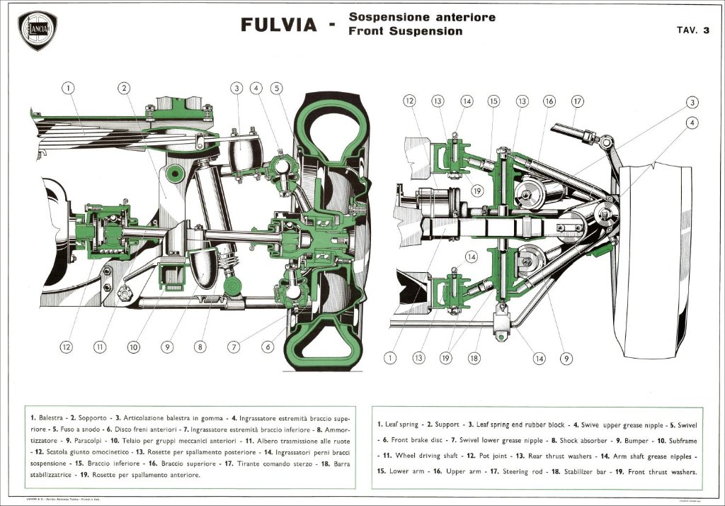

In the meantime study this picture of the Fulvia front suspension.
