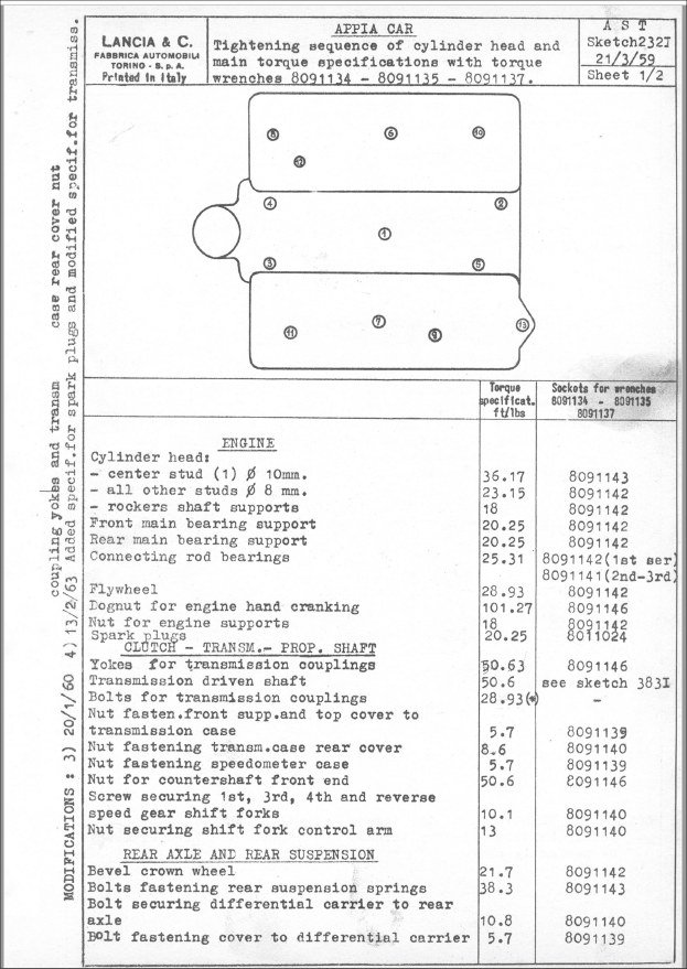

i've looked in my manual and tried a search of all the forums but i can't find anywhere the setting procedure for the front wheel bearing nut. the bearings are not tapered roller bearings but more like angular contact instead. is the nut simply brought up tight and secured? is there a torque value for this?

Right. Lancia uses dual or double angular contact. I will look it up.

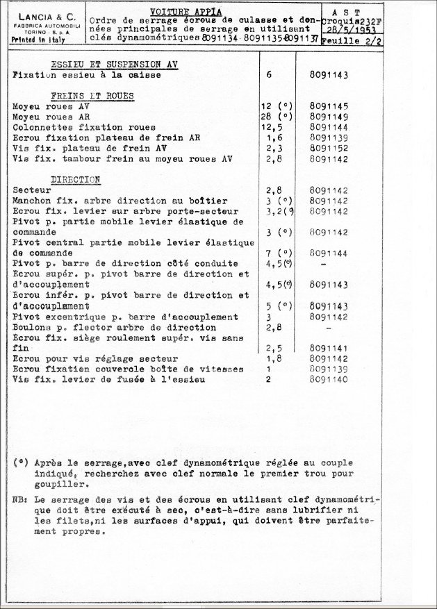

Here some copies of the pages on Appia CD_2 available on
https://viva-lancia.com/specials/cd/appia-cd.php
The last one is in French. It shows the values in kgm.
On the angular contact bearings. Fessia used the angular contact bearings. I am not sure Jano did.

The copies are definitely from the Workshop Manual on the Appia CD nr 2. There is no Data Tecnici book for the Appia.
On the middle page in the posting there is the section BRAKES AND WHEELS. The first line is front wheel hub nut 86,8 ft/lbs.
The French page lists Moyeu roues AV 12 mkg

ok, I feel foolish now. I have two copies of the workshop manual and didn't realize there was an appendix section in the back with all of the torque specs. I never would have seen the wheel hub torque listed right below the head bolt sequence. Thanks for keeping me humble...and reminding me to double check my documentation.
