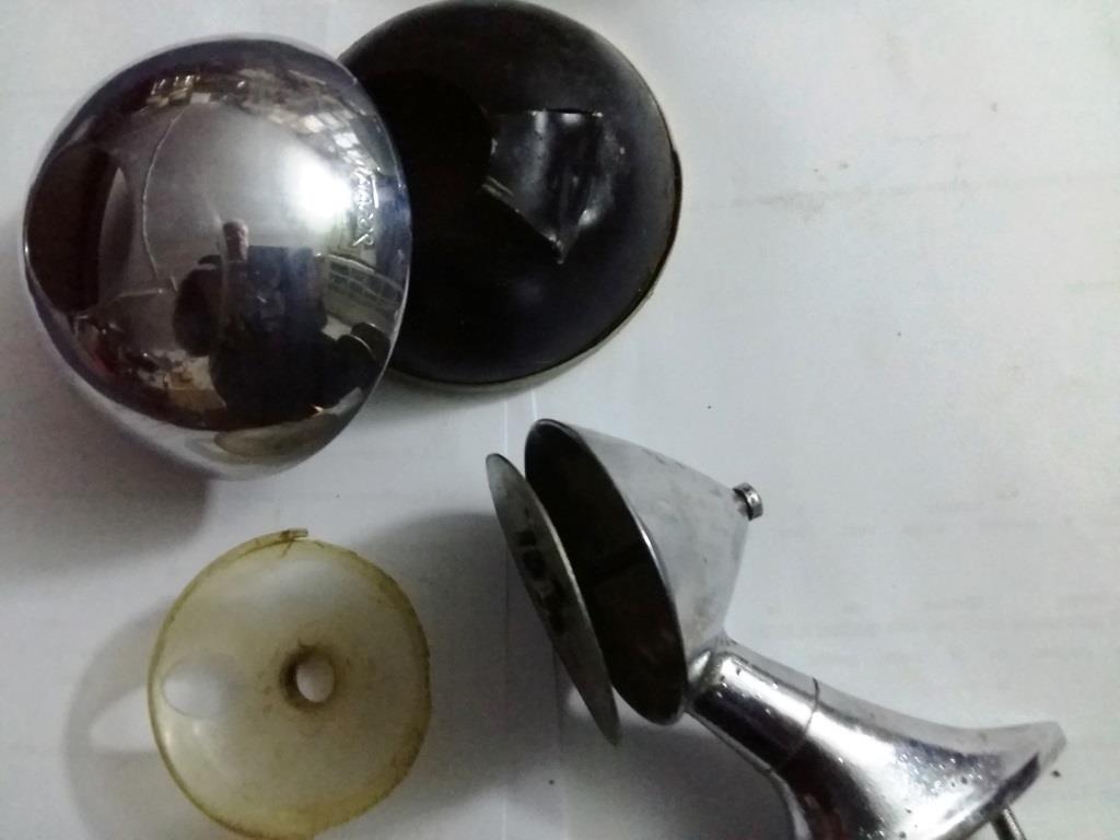

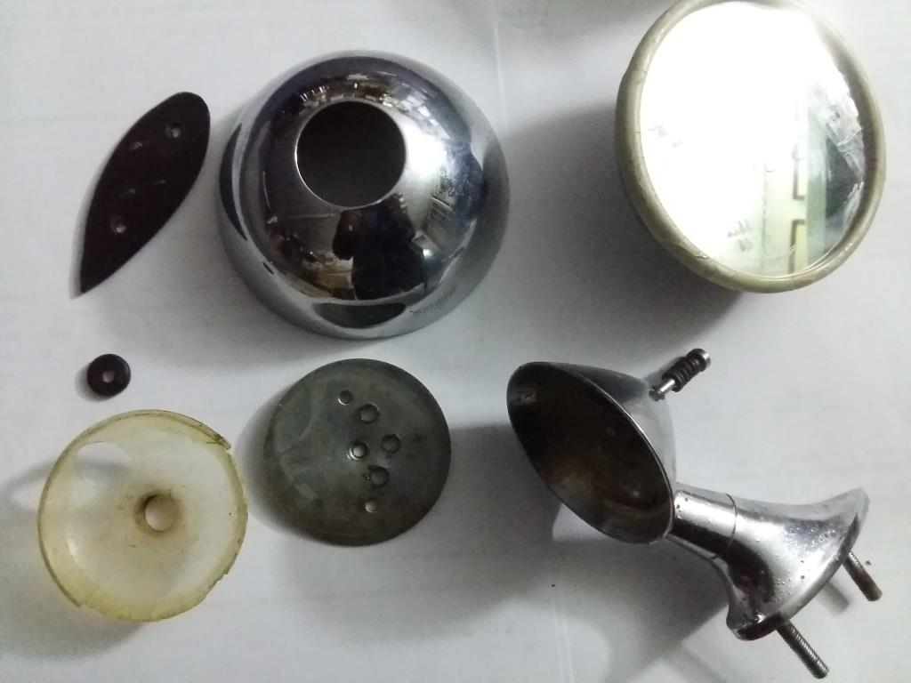

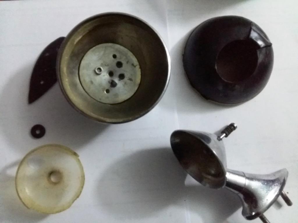

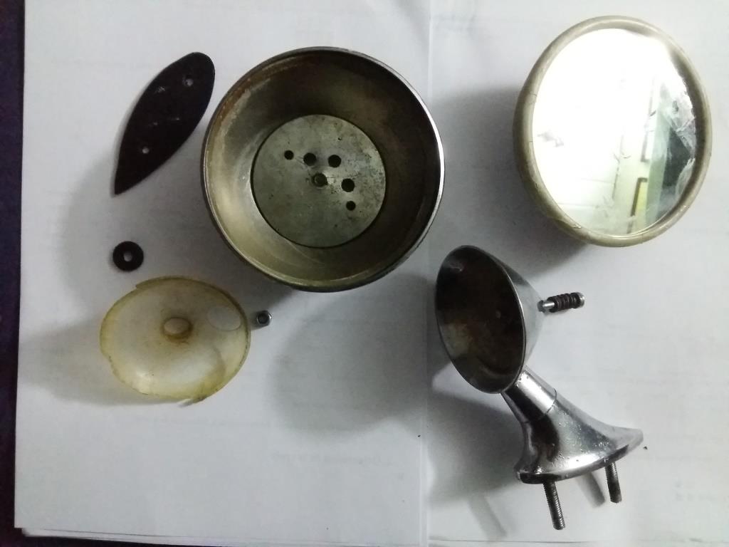

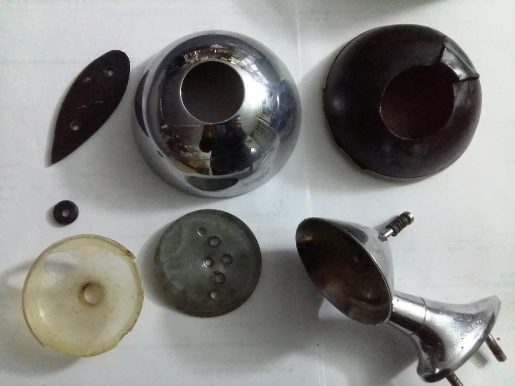

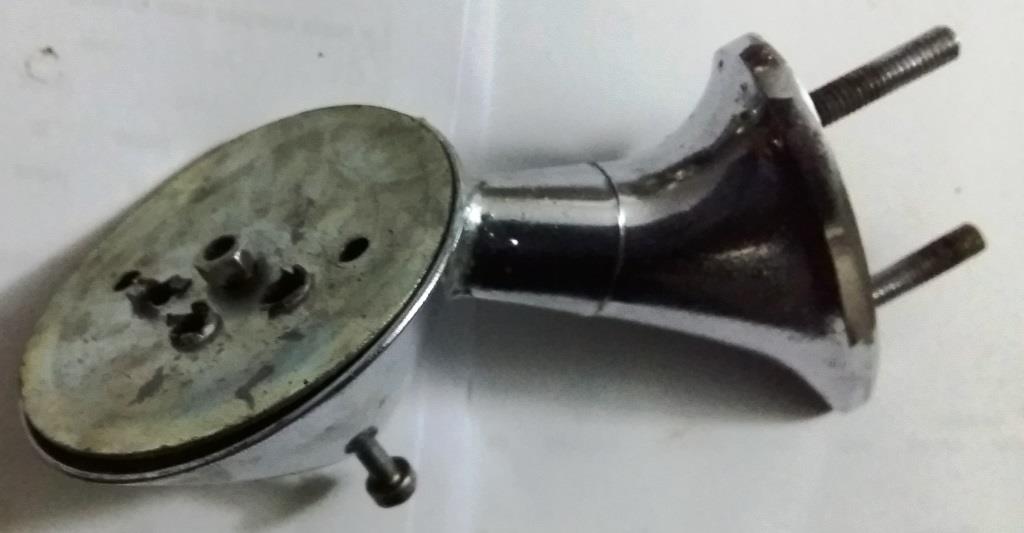

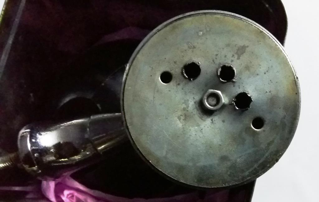

Hi Benny Sorry to come late, and to speak rather bad english language (I am french) Reading the topic, it reminded to me that I had a worn external mirror somewhere, and these last days I tried to put my hand on it. Successfully See attached pictures, As you can see, the black hemisphere (receiving mirror on front face) has been opened (not by me !) and I suppose that the round metal sheet with drilled holes was extracted by this way. The guy who drilled was not a pro.... By insertinf this round plate in the black bowl, and screwing inside the long screw with the spring, the mirror should be firmly fixed and operational, no silicon adhesive needed On the pictures, you can see that the "plastic" gasket and rounded "silicon" one are damaged. Fortunalely, my Fulvia coupé has 2 similar mirrors in good condition ( written ARCA)

last picts The round metal sheet drilled to receive bolt and screw has a diameter slightly inferior to the "shell" part. I hope someday somebody will be able to make new plastic parts with a printer...

@georges2 Thank you very much for these photos - very very helpful! The mirror is now back on the car - I ultimately ran a very thin bead of silicone around the outside of the mirror and it seems to be working well. If only I had steadier hands!
