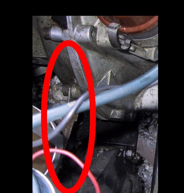

Brian,
the ground cable has to be connected to the chassis as shown on the photo.
- ground_cable.jpg (195.73 KiB) Viewed 3210 times
Hubert

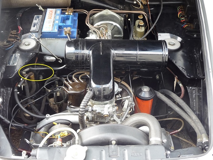

Hello guys,
I own two Flavia, an early 1,5 litre 815.00 and a coupè iniezione 815.430. On the early cars, the negative pole of the battery was connected to the chassis on the right side of engine bay in the coil area, the engine was conncted to the chassis with a huge copper braid (see picture). The same for the early coupè, convertible and sport. On the later cars (starting from 815.200 - 815.300 - 815-330) the negative of the battery was connected directly to the engine using the clutch bell bolts, On 815.430 the engine is connected to the front auxiliary chassis and to the car chassis through two ground wires, one from clutch bell to the central gearbox support, the second to the chassis in the fuel filter area.
On the wiring diagrams, the ground connection was clearly indicated only for the early cars (815.00 - 815.130-132-134), not for the later cars, see SAT sheet or workshop manuals.
Kind regards
Giovanni

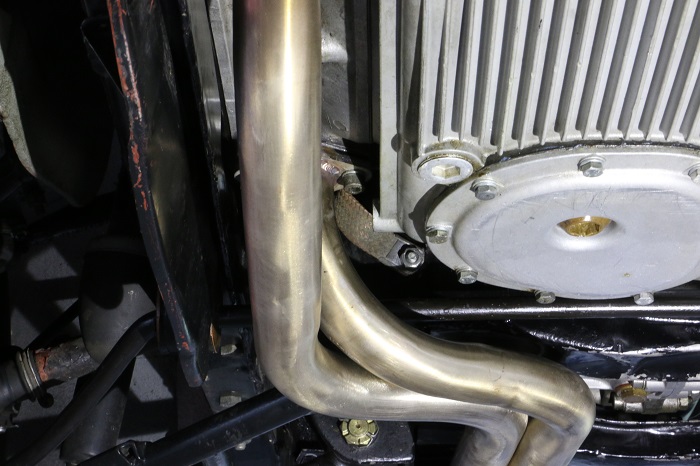

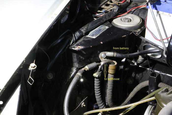

Re: Battery ground cable locations
It is just as Giovanni described. I went through the repairshop manual and found hints on chassis to subframe and chassis to engine ground connections, although the wiring diagram shows as Giovanni said.
My car worked with only the previously pictured ground cable installed, but has been upgraded today.
Brian, see pics how it is installed now. Subframe is in line with engine, which is in line with chassis to battery. Maybe it would be even better to go from battery to engine first (shortest way for high starter current), from there to subframe and to chassis

- chassis connection point.jpg (125.85 KiB) Viewed 3211 times
- ground to subframe.jpg (126.57 KiB) Viewed 3210 times
- ground from chassis to bellhouse continued to subframe.jpg (142.56 KiB) Viewed 3211 times
Hubert
