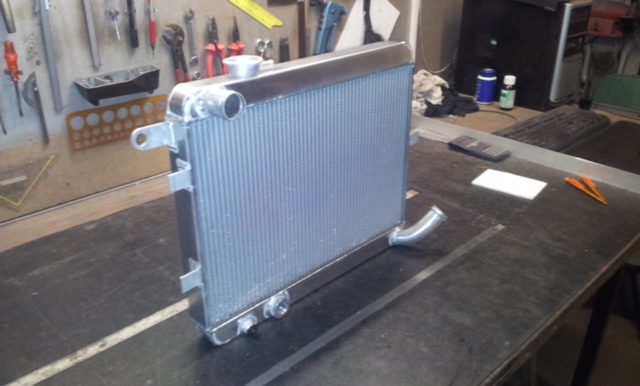

I've had a custom alumium radiator built by Hartgers Radiateuren (http://www.aluminium-radiateur.nl). Very knowledgable company and good value for money.

Does anyone have any experience with an aluminium cross flow radiator? I saw a post almost 18 years ago on this forum from a member who had one installed, but that was a long time ago (and that member is no longer reachable).
I appreciate any feedback. Thanks, Michel
