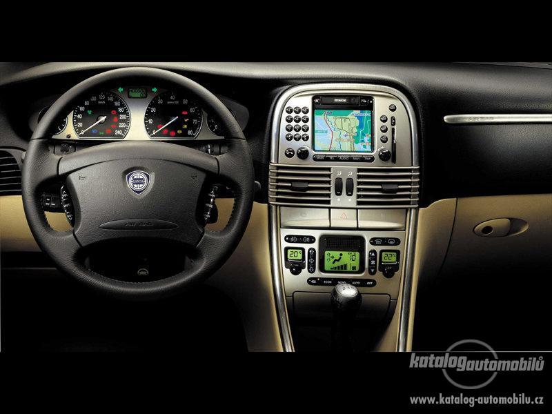

1. The chrome must be present on the dash gauges, it has most likely been changed.
2. The original shifting stick does not look like a universal bag.
The car's interior should look like in the picture attached.
