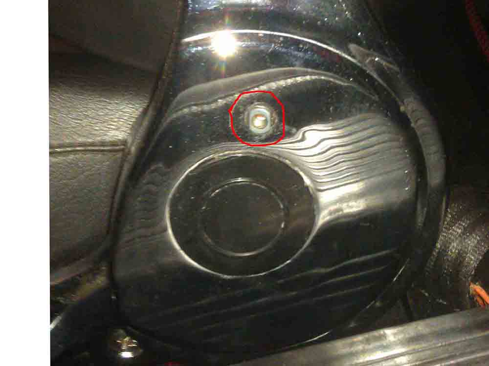

I'm restoring my Zagato seats and decided it's time to find out what is missing from the hinges. The attached picture shows clearly that something is missing. Luckily an upholstery shop I visited had a pair of Fulvia seats for renovation and I saw that there is a small knurled knob attached. Does anybody know how this knob works and what I could use to replace them on my seats. I assume the originals are as rare as hen' s teeth, so I may have to improvise. Can anyone advise me ?

Thanks guys, at least I now know what it is supposed to do. I guess a knurled flat knob with M5 thread and washer should do the trick.

After so long I can finally finish this story. Thanks to the generosity of a fellow Dutch Lancia Club member(many thanks Joop) I acquired one knob. After searching unsuccessfully I had the idea to ask someone who works with 3D printers. He made me one which is indistinguishable from the original. A thought worth bearing in mind for other plastic "hen's teeth".
