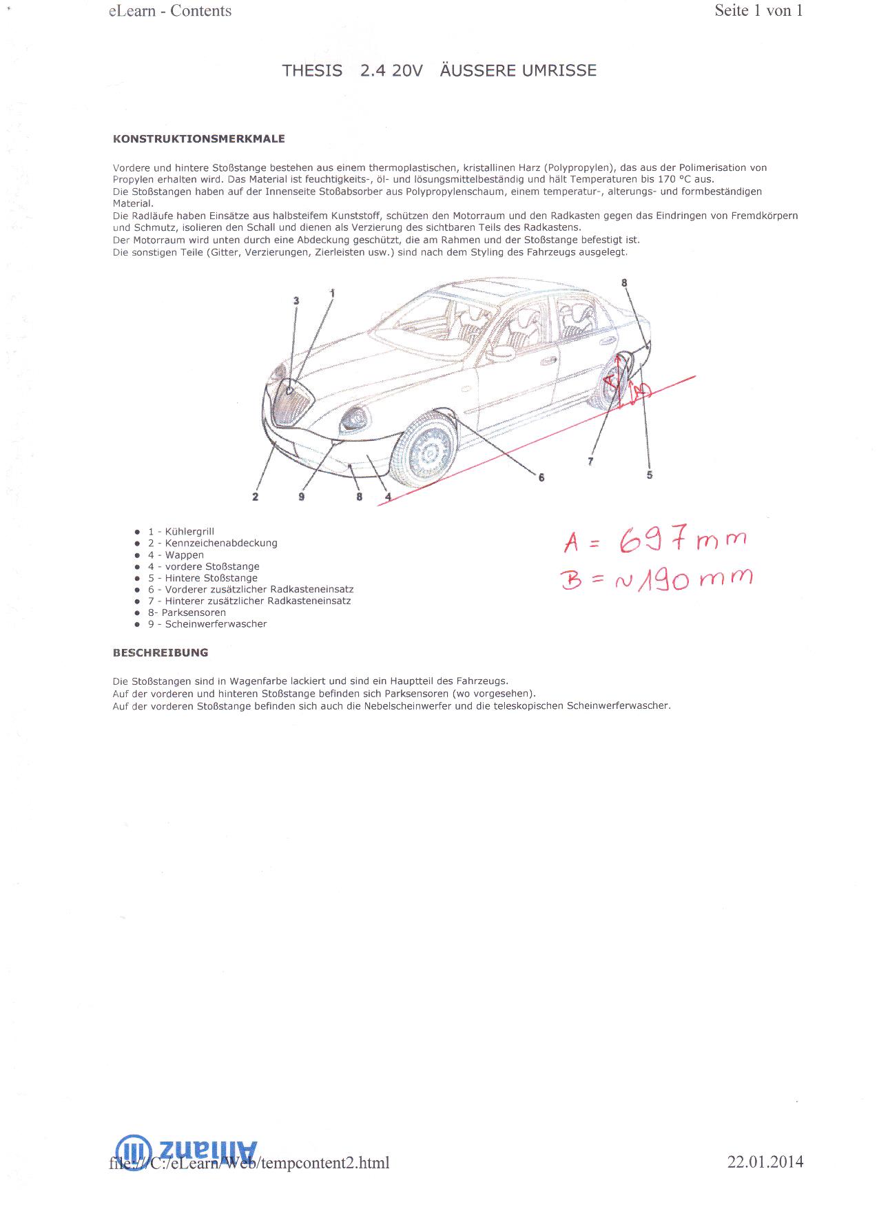

PLEEEEEASE would you be so kind and measure for me the car height on back? As you have the new springs I really need to know the height, the best would be to measure it between the road and the mudguard.

Hi Vladimir,
in the attachment you find a view where you can see it.
I hope, that this is the height you mean?!

Yeeees the A is what I needed
many thanks. But one more question. How full was your trunk and how much fuel was in a car while measuring that value?

In the trunk were only a few things (max. 5 kg) and I think the fuel tank was nearly half full (a little bit less).

I confirm, I have for measurement A (697mm) 694mm.
Re: Neue Federn und neuer Lenker
Many thanks man, why I need it is that after installing the towbar and liquid injecting lpg tank the rear has lowered and I can't load the trunk as before so I'm gonna add plates under the springs to have the original (car with new springs) height with all equipment installed in the car and filled up lpg tank.
