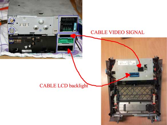

Re: Non funziona principale schermo LCD / Not working main LCD screen
Check the wiring shown in the attached image.
One carries the video signal while the other is for power and the backlight of the LCD screen.
- nit_lcd.jpg (27.04 KiB) Visto 254 volte
Hi
Only LCD not work, bought another one, but also don't work. Thanks for the diagram, I will check it tomorrow and let you know.
Thanks
i want to thank you all. when I was installing loudlink I have not connected one cable to CD module. I realized that thanks to Pietroth. After connecting it everything is working fine! Thank you all.
Now I have to change front arms and my thesis will be fully functional.
