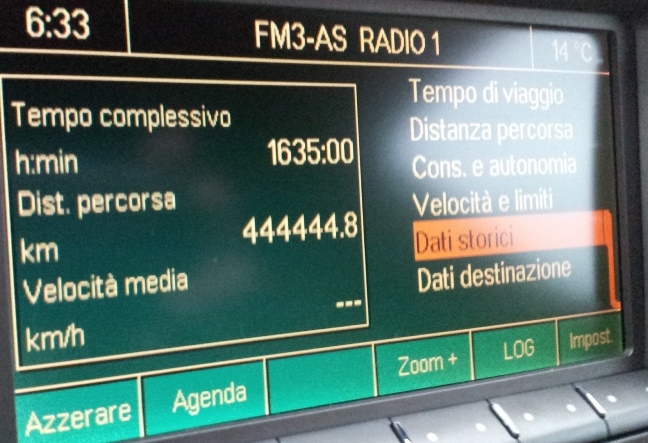

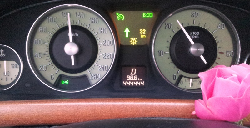

Dies ist kein Phantommeldung sondert realität ! Sieh Bilder.

Nice photos, but a pity that the kms are not real, just modified. This is usually done if car has even more, so we can see how strong thesis is. Here my friend is driving one with 200 000 on dashboard and 900 000 real kms

Hi Vladimir. I only lie about my age

I didn't want to tell that somebody is lieing, but the first symptom of milleage changing is missing average speed, sometimes it's missing because of something else, but the other datas is than cerrect, but in this case the calculated average speed is something more than tha cars maximum speed. Check the kms stand from engine ecu (if it was not reseted) and look also at the rewrite counter.

i think that Rino had sometime ago the "Chrstmas tree", or "EOL Error" problem.
I have the same "problem" with my Thesis, the average speed is not more calculated, i think that it begin at about 40 000km. In this time i had this electronic problem.
If you have the christmas tree, the time would not be saved, but the kilometers. And the connect reads this information from the main unit. If the calculated average speed is not logic, it will clear this field.
When i calculated a average speed from over 270 km/h for Rinos Thesis, i thought i made a error with my calculation.
