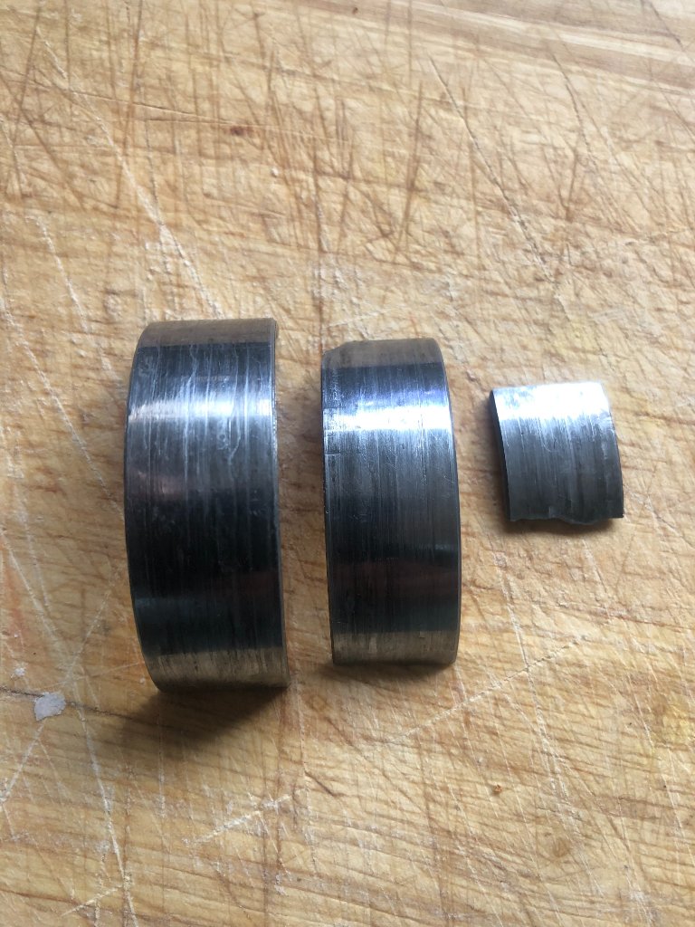

I have attached a new picture of the shells that show the damage better. The tangs are missing. How could they break off and where did they go???
I know a bit about engines but am no expert but I would really like to understand what went wrong before spending loads of money.
Thanks again

PS. The broken shell is from bottom cap. The top shell was firmly in the cap. I have inserted shells from #4 just to test fit and they fit well in the caps so they have not been heat distorted.

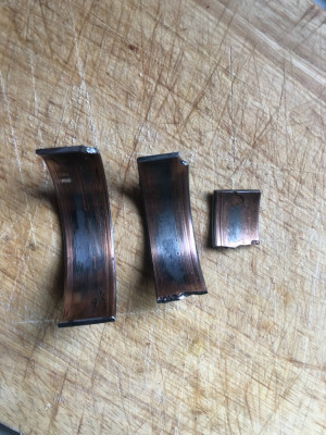

I have attached a picture of the underside of the shells. There is some scoring so is this a definite sign the shell has been spinning? I am not knowledgeable enough to cohttps://forum.viva-lancia.com/download/file.php?mode=view&id=58959mment. When I removed the cap both halves of the shells were in the correct position.

There are a lot of possible reasons.
But the main point will be the Oil sludge in the inlet bores of the crankshaft. I have Open a well running engine with
good oilpresure. The bores were complet closed. The Crankshaft bearing of the first Bearing point was also complete gone but not broken.
The pleuel bearings not good but with normal wear.
What i have also found was different size of the shell
on one bearing point. No joke. So check also the numbers of the shalls and the diameter of this bearing point.
And I can‘t believe that the crankshaft didn‘t have any damages or significant wear.
The broken parts may be gone by oilchange or inside the Engine

Only the #1 big end was bad (photos) the other 6 all good and all plasti gauge to 2.25 thou including #1 with good shells in.
#1 big end journal good with very slight scoring along 1mm edge of journal suggesting shells may have slipped sideways at some stage.
I am not 100% sure because as I dropped the cap I was so surprised to what I saw ( the small bit dropped out and was resting on the bigger bit as i lowered the cap) but reconstructing the event I am sure this big end cap was installed 180 degrees out. ie the shells were in the caps correctly but installed tang to tang not tang to flat end. Could this cause the damage in the photos? The engine has done about 18,000 kms since overhaul.
