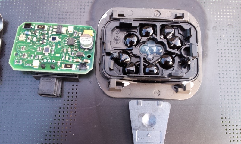

Re: What do you miss in your thesis? Speedometer backlight
unfortunately the sensor for the speedometer backlight is together with the sensors for the headlight and the windscreen wiper assembled in the same unit. See attached picture.
- lens-voorruit1.jpg (196.39 KiB) Viewed 352 times
