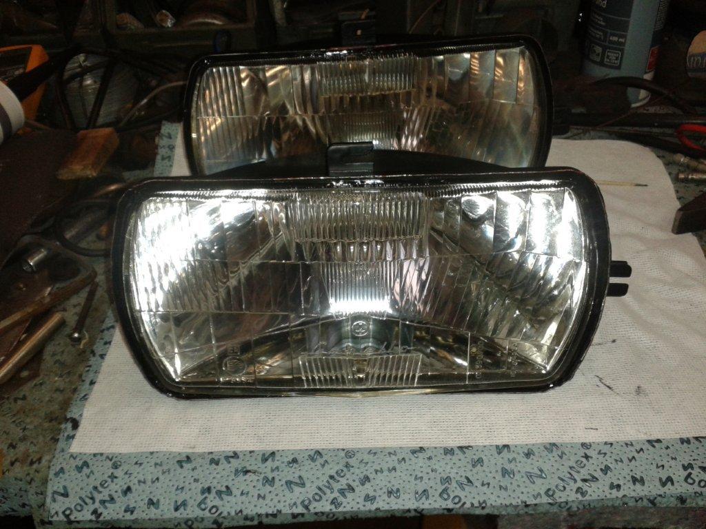

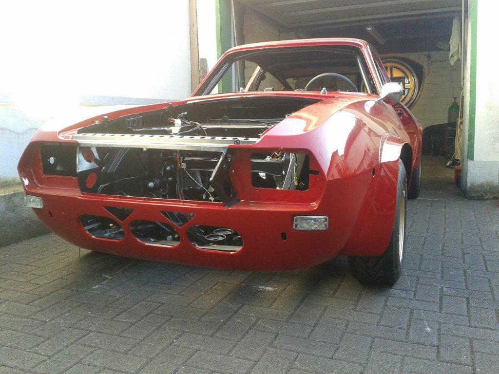

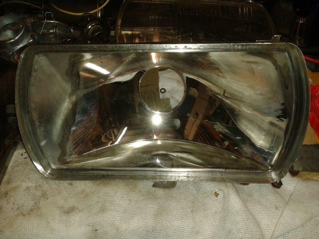

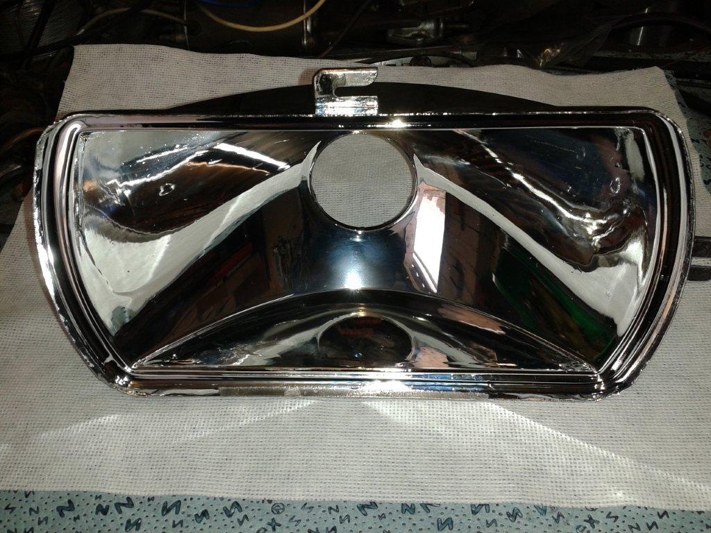

Up Date;
Back on the wheels
reflector with new surface
regards
Andreas
Back on the wheels
regards
Andreas

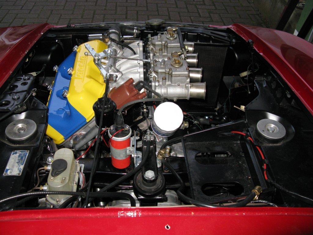

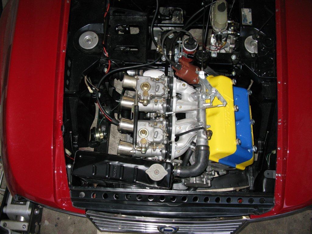

Re: Aldo Broverone's Opinion on Fulvia Sport
Update :
Ass.and installation of the engine and gearbox is done.
Some problems with the bonnet depent of the carburators occured but solved it by " lowering" the gearbox and the engine by
shorten the rubber´s of the mounting. Moreover a small modification of the intake manifold.
regards Andreas
regards Andreas
