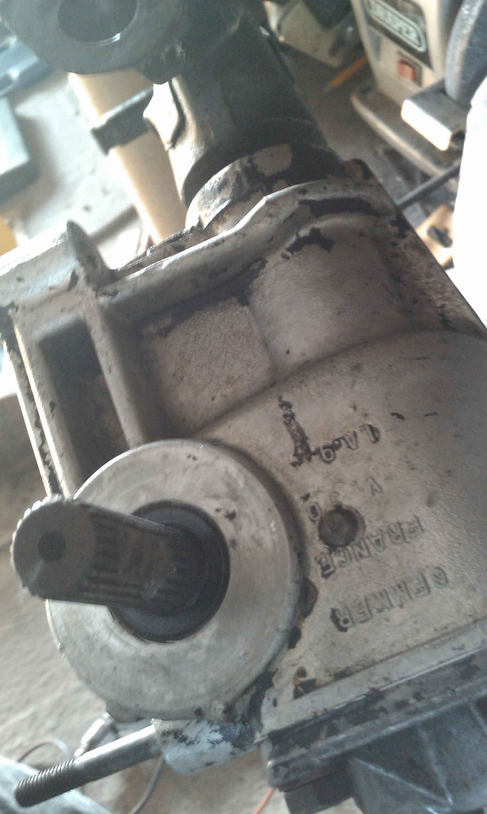

Here is a pic of my spare hf box with centralised steering. The flat points to the casting lettering which is in the "11 oclock" +or minus when the box is mounted.
You may be a spline out.
