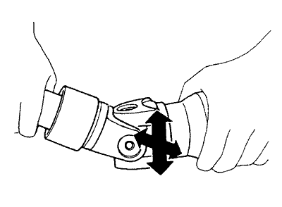

Re: Steering Column Bearing - Picture
quote "I can move the column up, down, left and right in a circular motion if that makes sense"
don't you have radial play then?
And have you checked crosses(see pic) on your steering column?
Bart
Bart
- driveaxle4.gif (3.92 KiB) Viewed 800 times

Bart uploaded a picture of one of those joints. Most problems I find on customers cars are with those joints. The pins come out. Utterly dangerous. I don't understand how Lancia managed to build something where this can happen.
