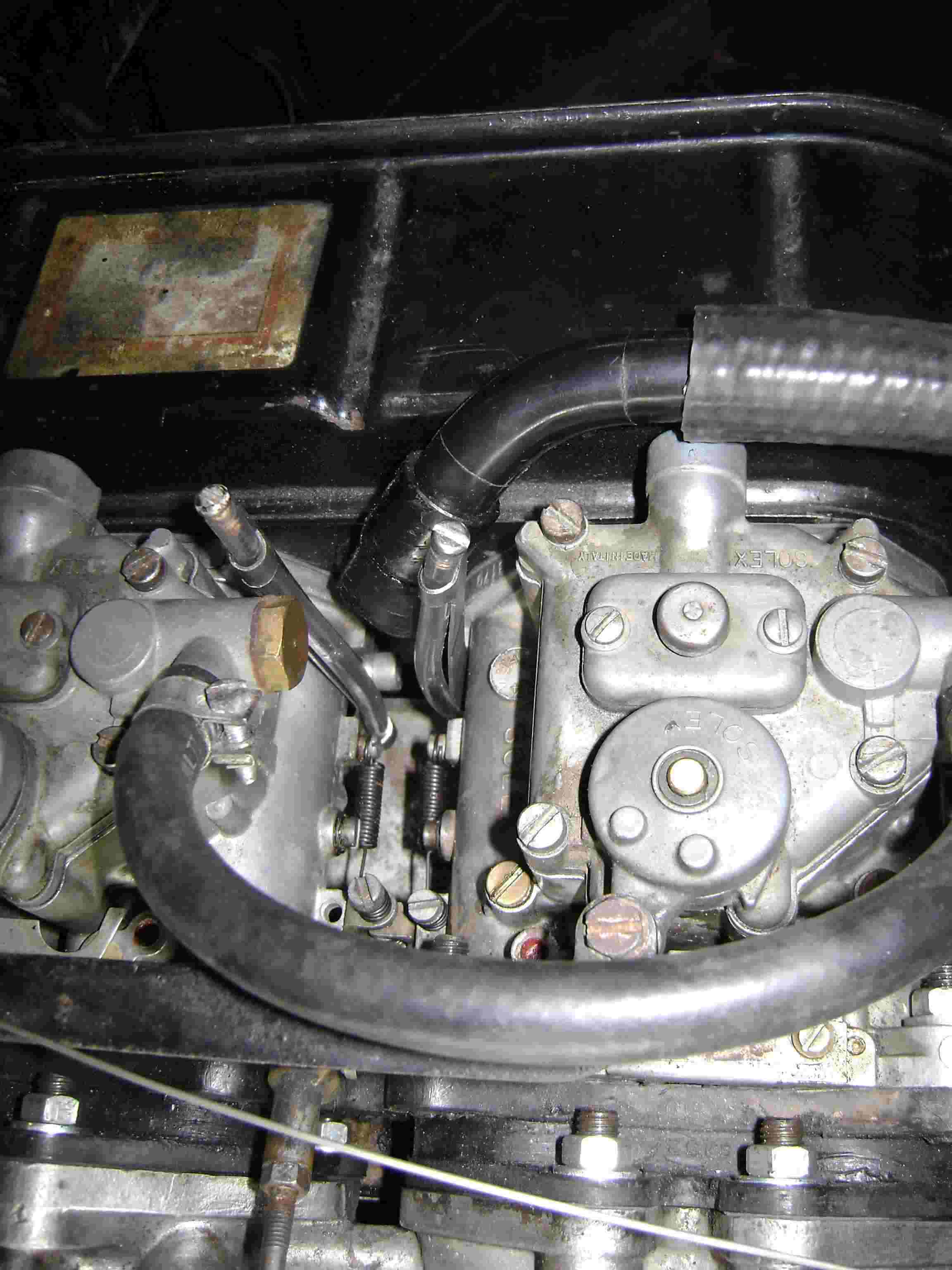

I had the same problem; fuel level turned out to be too high. But I only found this after making small sight glasses in the carbs, so that I could actually see what happens inside, during running of the engine.
Cause of the problem was probably wrong size (thickness) of brass washer under the needle valve. I found the fuel level to be quite critical for good performance.
