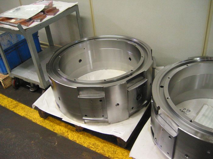

My vote is that startup is critical.
I once was in a bearing plant that made huge bearings for military and industrial equipment, such as generators and submarines. They had a babbit bearing housing, tolerances in the hundreds of thousandths of an inch, about 3' across in diameter! The babbit was in four quadrants, or quarter sections of the circle. It was about 1' wide. Each quadrant piece of bearing could float a wee bit to align closer to the shaft as it came to rest.
They said the reason was that in the long shafts of submarines, the shafts had a tendency to settle at one resting spot, and in the wee moment of startup, any slight intolerance would cause damage. The floating section of bearing would get a closer alignment to the shaft, and avoid wear on the shaft.
The photo is of the housing, and you can see inside the mounting points for the quadrants, and the sliding sleeves on the outside.

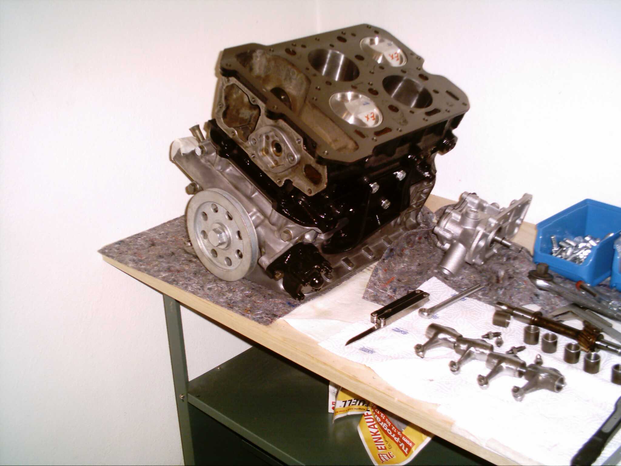

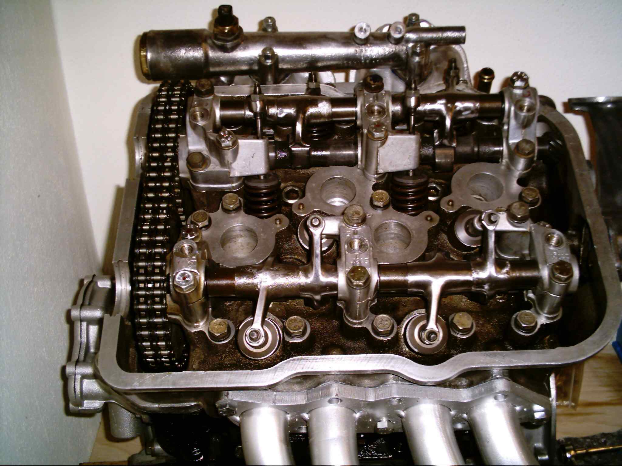

Nice Engine Andreas!
Did you polish those rockers?
Re: Oil Pressure Zero
not only polish; they have now all the same ( reduced) weight. And maybe you can see the springplates are
different from the original. I have made them in Aluminium ( tensil strength 500 N/mm² ) and anodise to reduce the weight, too.
The engine reves up like a bike engine. Compressionratio 11:1 with CPS- Piston. Cams with speciall racing profil.
( and and ...)
regards
Andreas
