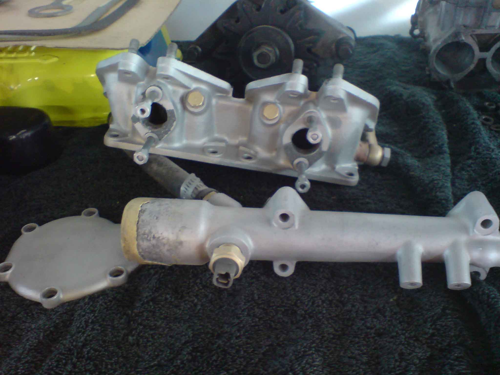

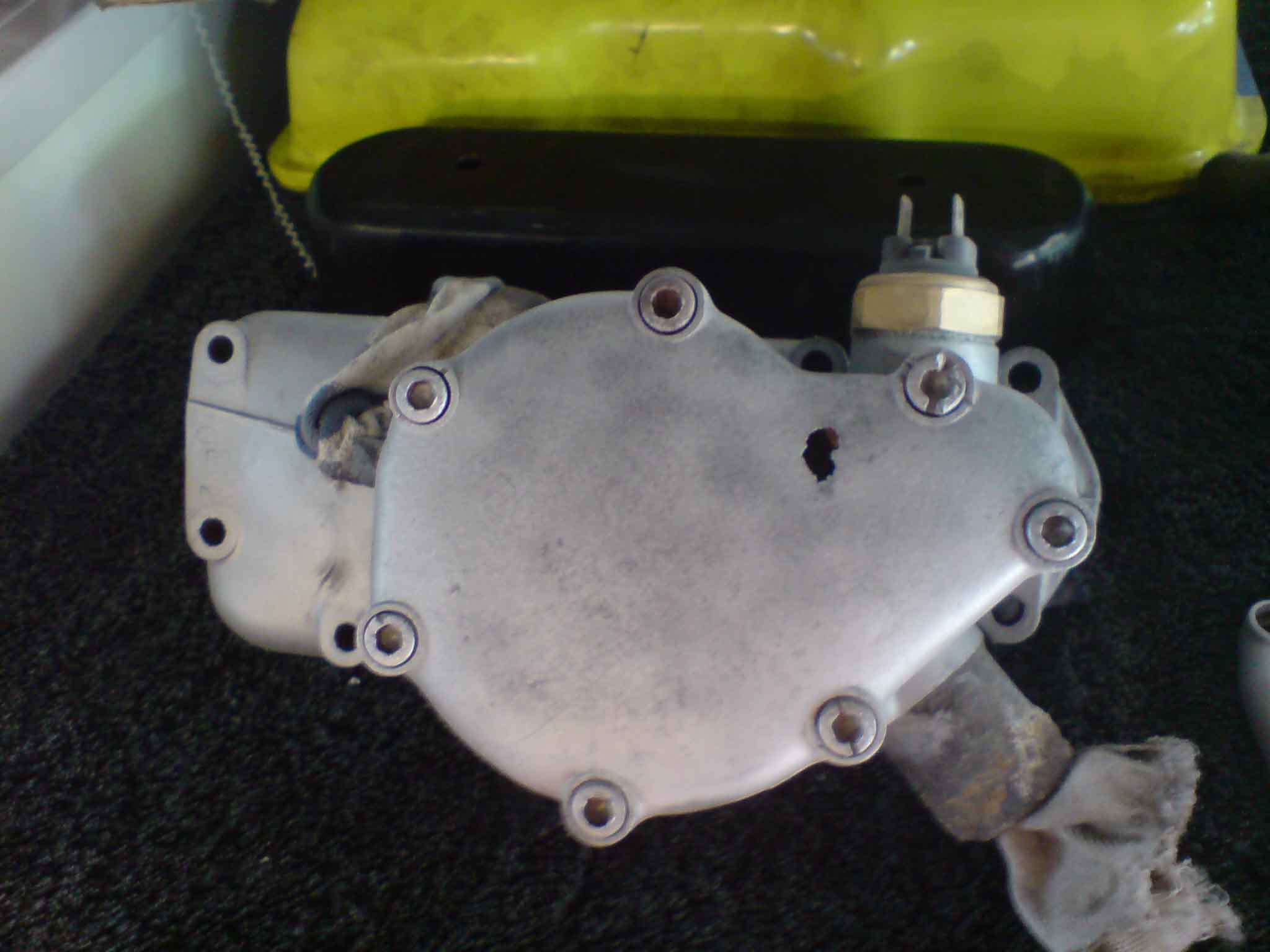

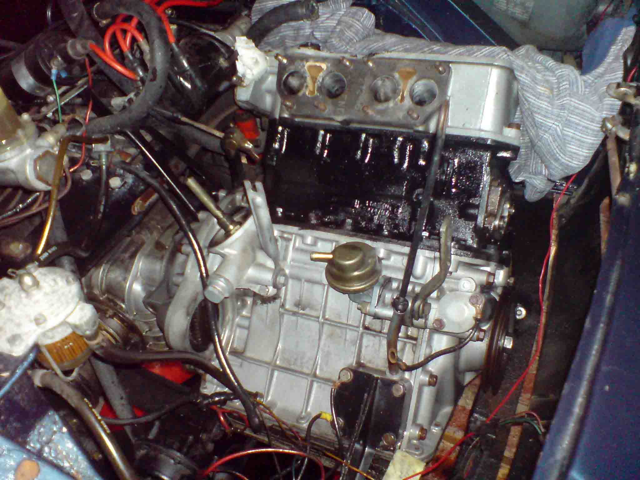

Despite now having a very clean engine and some very clean components, the water pump (oh no not a waterpump again) (td)cover plate had coroded so badly from the inside that when I sandblasted it it blew a hole right through the cover (see pic).... and of course the alan key bolts are all stripped.
.....and guess what was attached to the magnetic sump plug when I removed it...... a timing chain link plate.... and not my fault as I have all the ones I removed. Motto "never let a mechanic who specialises in all makes of cars" work on your car. You are better of on your own even if you know very little. At least you care!
....and no termostat fitted and of course some of the bolts on the sump are stripped.
Oh the most important discovery is that the spring fitted to the timing chain tensioner was some 2 cm shorter than it should be!
But I will persevere and the 1600 will regain life shortly.
Does anyone know of a thermostat that will fit?
Phil

Re: The Saga Continues
I agree with you to never let a non specialised person work on a Fulvia. I see quite a lot of VERY CREATIVE "Engineering".
I wrote something about the thermostat in the Fulvia Q&A.
See http://www.viva-lancia.com/fulvia/qanda ... mostat.php
The Wahler 3029.83 hose thermostat is a good alternative. It fits in the hose and costs practically nothing. Drill a 1.5 mm hole in it and put the hole at the top. Put a tye wrap around the hose where the thermostat sits to avoid water leaking around it.
