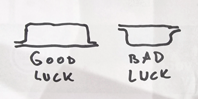

The cross member is flat on the bottom side with two vertical parts to it each about 1.5 cm in from the bottom edge so I guess the bottom is about 2-3 cm narrower than the top. Is that what you mean?

My sump is loose but I cannot "wiggle" or "wriggle" it free of the oil strainer. My car is a series 1 sport so and I know about the problem with the cross member.
My cross member is U shaped with a wider strip welded at the bottom (road side). Huib has mentioned that with this cross member it should be able to
get the sump free of the strainer. What am I doing wrong? Is it just a case of my wriggling is not quite correct but it does seem that the sump hits the cross member before clear of the strainer. so
1/ Tips please for wriggling the sump clear.
2/ Would grinding a mm or 2 from the flange of the cross member help?
3/ Removing the cross member looks a pain and I guess putting it back would be even worse. Any tips from those who have done it??
4/ Maybe time to get the cross member changed for a series 2? Who supplies them?
Thanks

I am afraid you will have to remove the cross member, it is a pain so you will have to bite the bullet. Andrea

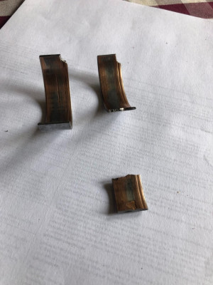

I have a good luck crossmember and managed to get the sump off today. The side member was bent fowling the sump twisting and dropping.
Investigating the rumble in the engine under load. #1 big end shells were in 3 parts with the tangs missing!! I suspect it may have been spinning.
Amazingly the crank journal looks OK. The 3 other big ends are fine. I will try and post a picture. Engine only done 18,000 kms from O/H

Has any one seen that before? I suspect the last rebuilder managed to put a shell in the cap the wrong way around. The bolts should only be about 35 ft lbs but they were incredibly tight (I estimate double that) so whe the rebuilder tightened the bolts he had to crush the shell to make the caps fit???
Any ideas?

Never seen before. Amazing.
You did well in getting the thing off. At first it seems you can't get the sump off. Take a good night rest and try again. There is a sneaky twist.

Huib. Have you seen big end bearings break like that?
Andrea Nistri
Posts: 620
Joined: 07 Jan 2009, 14:46
Re: Inspecting bearings without removing engine
Unread post by Andrea Nistri »
If you know who built this engine, stay away from him...Andrea

Learjet wrote: 04 Oct 2023, 21:25 Huib. Have you seen big end bearings break like that?
Exactly similar I have not seen yet. Plenty of other though. A car of the 60's typically consists of 12000 parts.
