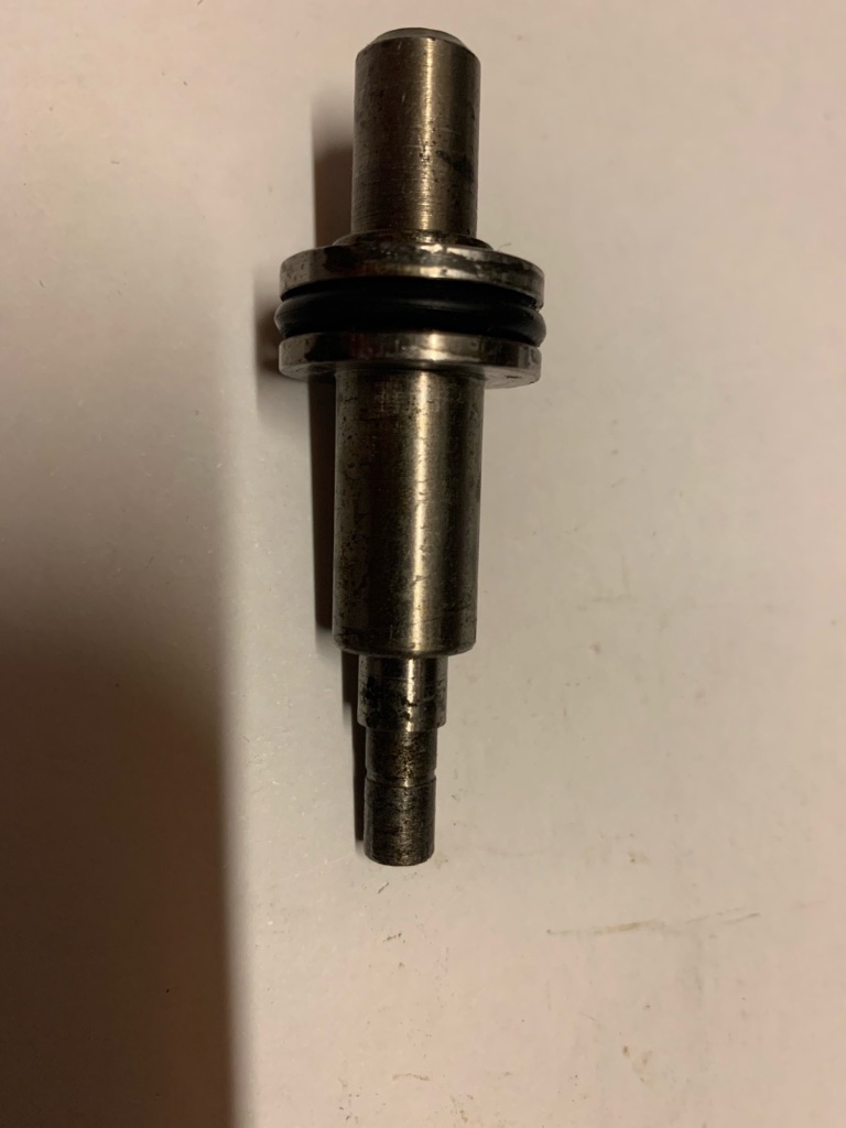

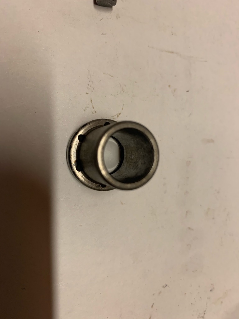

Can you also post high quality pictures of the plungers taken from the side.

I will post a picture of the plunger tonight

Now with pictures
[attachment=1]34FE824E-0165-4B39-BADF-600FE8531A26.jpeg[/attachment][attachment=[attachment=0]B0121E65-BA59-4177-BE10-61A275F9282C.jpeg[/attachment][attachment=1]34FE824E-0165-4B39-BADF-600FE8531A26.jpeg[/attachment]

Unfortunately I cannot get the pictures into the post in higher resolution - sorry [attachment=1]B7EE22B7-F1BA-4380-BEC1-00AD3FB69E65.jpeg[/attachment][attachment=1]B7EE22B7-F1BA-4380-BEC1-00AD3FB69E65.jpeg[/attachment]
