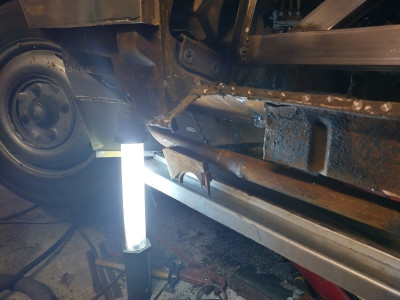

No pictures yet, but I can tell you that it is not a pretty sight. ;) All internal structures are gone from bottom to top of the sill, it was just patched on the surfaces, and quite badly. The rearmost connection of the auxiliary frame had been repaired for roadworthiness inspection so, that piece of sheet metal was hammered under the bushing, and "welding seams" were fabricated with sealing compound. It won't be much fun to fix that properly in my cramped garage. :) So, the supports are pretty much completely gone, there's practically nothing left to patch, and new ones will need to be made.
The "center wall" of the sill will be renewed from the middle of front seat to the front wheel, and some 20-25cm from the rear, so the tube will not be removed. The ancient Tectyl-treatment has saved a lot where the dirt was not accumulated.

Damned, now I see that there was supposed to be an additional beading on the floor pan under the sill - the original sheet metal was gone so I had no idea. And now it is already welded in. :/ So probably I will cut off that part of the floor and weld a correctly shaped sheet in place.
Other than that, looks very familiar. Fortunately in my case the issue is probably only on driver's side and the sill on other side should still be intact.

Those pictures are actually very valuable for me to see how those parts repaired in the past have originally been constructed. The outer sills have different structure on berlina than on coupe.

Everything gone. What is seen of the internal support on the picture, is almost everything that there was left. Made a mistake with the floor and sill, should have installed the inner wall of sill first, before the the bottom of the floor/wheel arch. Now it will be more challenging to make it fit nicely.
The wires were glued by old cavity wax in the tube. When one was finally moving, the rest began moving one by one. The last one was still pretty tight.
