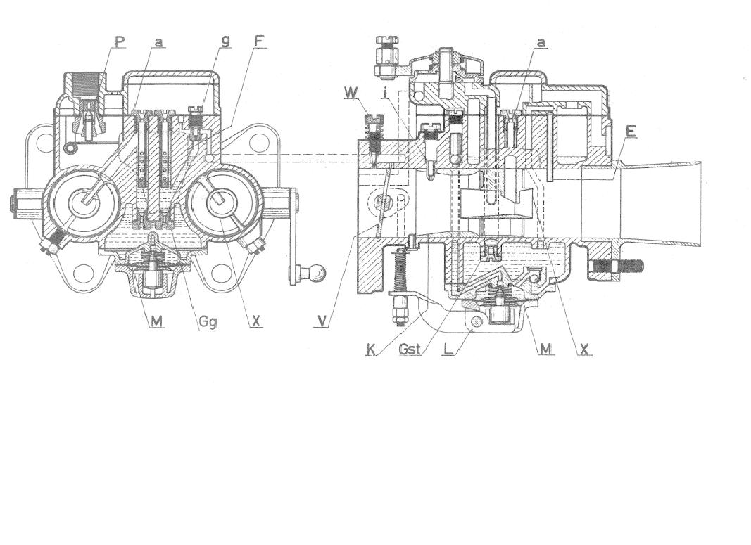

The attached image may come in handy to name and identify the parts.

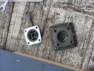

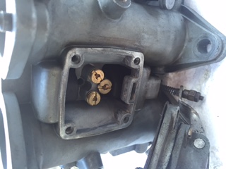

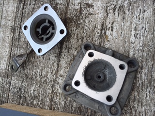

I got the carbs of the car again and removed the accelerator pump castings to check their flatness. I got a flat board, make sure its completely flat (a mate tipped me to use a piece of glass/mirror, didn't have it), on top of that I used fine 800 and 1000 sanding paper to smooth out the pump castings by just gently pushing down and sanding them on the paper in circular motion. Using the 800 first and then the 1000 paper.
Visible in picture 1 and 2 you can see the before and after results. In picture 3 you can see the bright part showing after the first sanding action and it is on the corner, showing that the darker bits that do not fully seal..

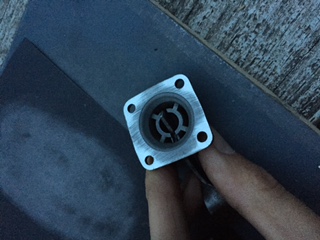

When it comes to the upper mating surface of the pump housing and the underside of the carb (picture 4) itself it becomes a bit more precise to sand this smoothly, here is how its done: use a piece of the same flat board and cut/saw this to a size slightly larger than the surface on picture 4. Put a piece of the sanding paper around it and use this are your sanding block, going again in circular motion over the surface on the carb bottom until it is shiny. For the upper side of the pump housing use the side of the sanding block you've made.
