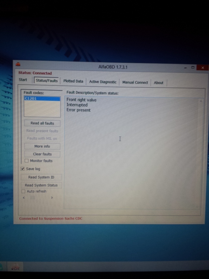

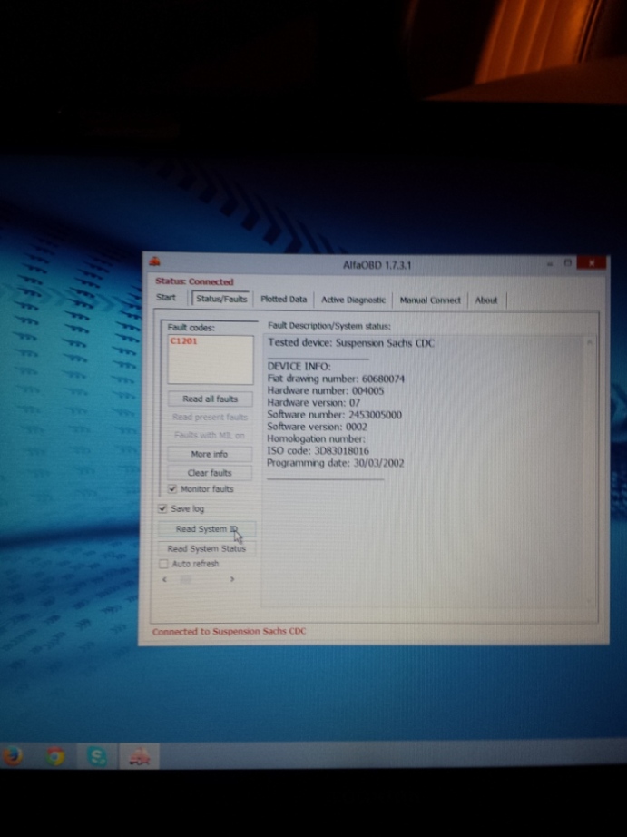

Hello,
Yes, I did testing as suggested. Everything seams ok, however the problem persists (error warning on the dash, plus C1201 on AlfaOBD diagnostic). I check all the connectors and disconnected battery (-) for 10 min. No improvements. Here are the photos of the C1201 error code. I heard a squeaking noise from the right shock, immediately after I started to drive the car (the same noise when I had the problem with the shock which was leaking (the new shock is gas, not an oil one). I purchased 4 shocks last February and I put less than 10,000 km.
The diagnostic shows the same error C1201 when the shock is connected or disconnected (of course I deleted the errors in between testing). The left shocks reacts normally (error is displayed when shock is off - error disappears when shock is re-connected).
Any ideas?
Any ideas?
- lancia thesis 2.0 - error code c1201 -2.jpg (158.34 KiB) Viewed 1757 times
- lancia thesis 2.0 - error code c1201 -1.jpg (159.82 KiB) Viewed 1756 times

Re: Skyhook
I know it is not simple, but could be work. Put out the shockers and change them (not physically just connect it). Now run a test. It the diagnostic say font driver side error, you can be 100% sure it's a shock error and not electric.
You can see if you have problem with oil shock. Now you used a gas version. It is not possible to test it.
