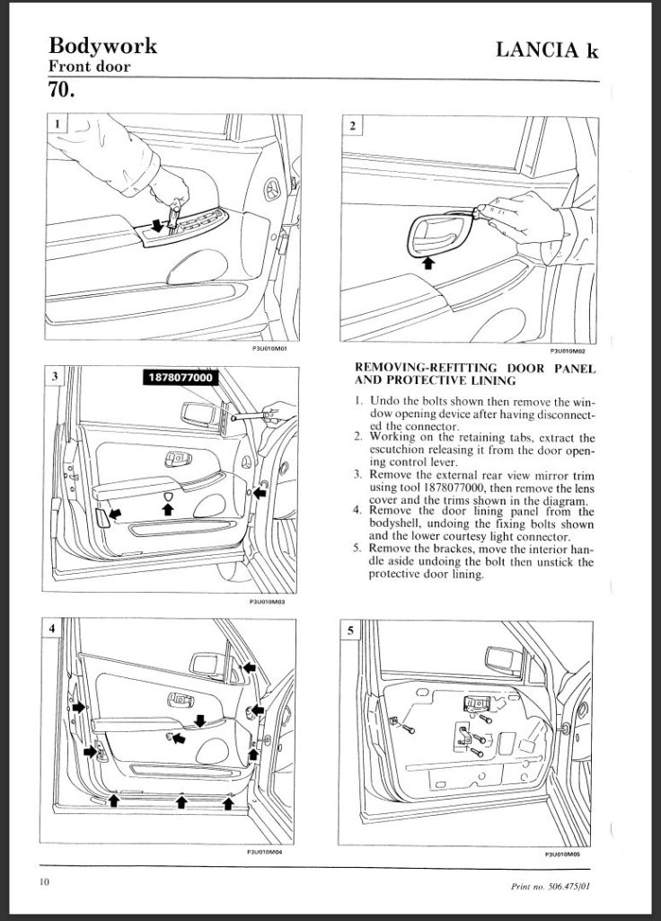

I found this one for a Kappa 4 doors :
Daniel
Hope this helps, Daniel

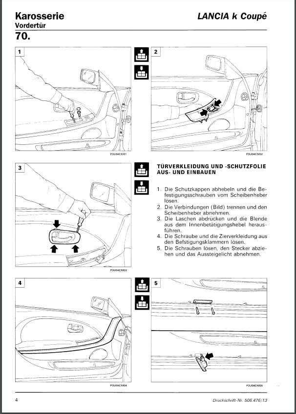

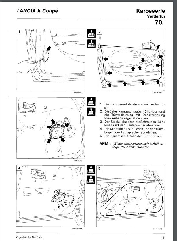

Found it for K coupé !
You can find the original document on this page :
https://www.kappacoupe.de/technik/kunde ... -handbuch/
Daniel
