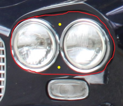

Hi, can anyone tell me how to remove the headlights on a Flaminia Touring.
I can't see any retaining screws on the bezels or the painted fascia panel that the light sit in.

Sorry for my very poor english … and my poor drawing skill.
You need to remove the facing piece (body color) surrounding the headlights. In red on my picture.
For that, there are two nuts screwed on the inside face of this piece, access in the front wing by the engine compartment .
These nuts are located roughly behind the yellow position.
Not very easy, so for my own, I start by removing the front grille to access the lowest nut. It's better if you gave very small fingers.
When this facing piece is removed, it's easy to understand how to proceed. There are three screws to remove the stainless piece surrounding each headlight.
Regards.
